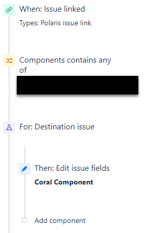

I'm trying to set up an automation rule with the following logic:
  • When I link a delivery ticket to an idea in JPD, I want the custom field of that idea (="Coral Component") to be set to one of the options of that custom field.
  • Which option it should be depends on the Component (Jira Cloud) field of the delivery ticket.
  • See my script below.

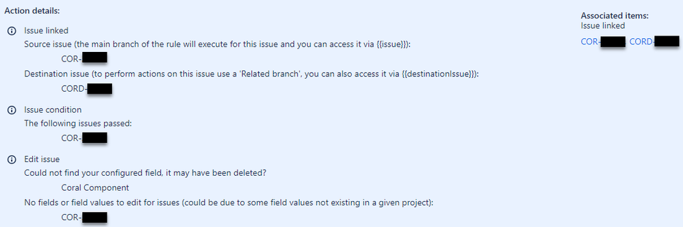

But then somehow Jira Automation is not able to find that custom field in JPD, see:
Is there any solution to this error? Thanks!

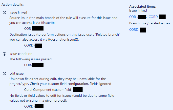

I updated the rule with the following JSON (note that XYZ and cf_123 are of course updated in my actual script):
"update": {
"customfield_123": [{
"set": "XYZ"
 But unfortunately I still receive errors upon running:
Do I need a system-value for "set" as well, rather than the text-value "XYZ"? If so, how to find that one?
Or if not, what could possibly fix this?
Thanks once more!

Mart Postma
November 15, 2023
@Bill Sheboy @Marina Rambo
Unfortunately still no success...
I'm afraid there is no other solution left other than using the web request in automation. Do you believe that would work?

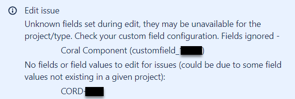

Mart Postma
November 15, 2023
@Bill Sheboy
First, have you confirmed that your field is on the views for the issue type in the target project, CORD? -> Yes
Who is the actor for your rule?  The default is Automation for Jira, which has permissions to change lots of things.  If the actor was changed it is possible they do not have the necessary permissions. -> Automation for Jira, did not change the actor since creation. However, I think I found out that the issue lies there. When I change the actor role to my own account, the automation suddenly runs and executes as expected.
Finally, let's confirm the field can be edited by automation rules using this how-to article.  Essentially you find an example issue in your CORD project that has this field set, call a REST API function using a browser tab, and search for your field on the page (e.g., with CTRL-F).  If the field is not present, rules cannot edit it.  -> Yes, field is present.
