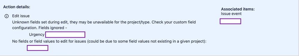

It provides the following error log:

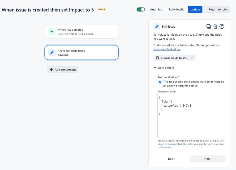

Kevin Gough
July 23, 2024
Hi @[deleted] @Nick Haller
I'm trying to achieve the same thing but this isn't working for me at all despite following the steps.

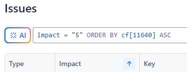

1. Found the field ID for Impact using the issue navigator.
2. Created the rule using the same JSON as you.

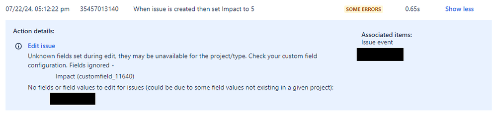

3. Keep getting errors in the Audit log
4. Tried with another rating field and a slider field as I want to create automations for them too but same results.
5. Fairly certain Automation for Jira has permissions on the Discovery project as its executed other rules in the past.
Any ideas why this is not working and what I could be doing wrong?
Thanks,
Kevin
Nick Haller
July 23, 2024
Hi @Kevin Gough ,
Your rule appears to be configured correctly - so my guess is your A4J (Automation 4 Jira) user does not have JPD permissions based on that error, and what other customers have reported.
Please open a ticket with JPD support HERE or in JPD through the Give Feedback tab >> Get help from the support team option.
We on the Atlassian support team can get this user enabled / the correct permissions. Unfortunately this cannot be controlled from the customer's side.

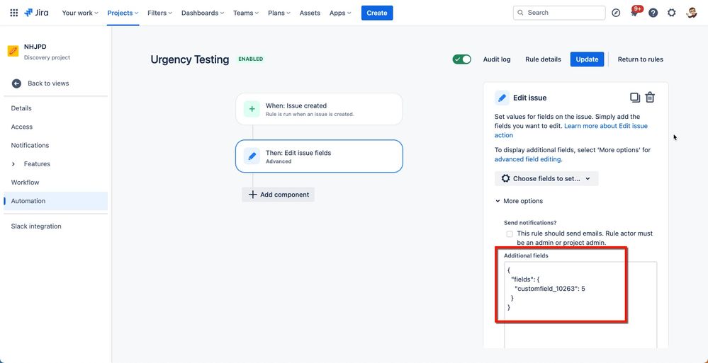

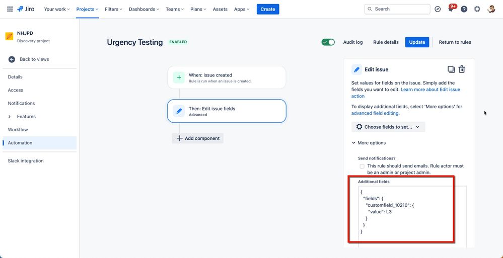

Nick Haller
January 8, 2024
Hi @[deleted] ,
The Urgency field is system field that I believe is not available for JPD out-of-the-box, like it can be selected for other Jira projects.
I was able to test successfully with a similar automation, and a custom Urgency (single-select) field with this type of rule:
In the example above, customfield_10210 is my custom Urgency (single-select) field. You should be able to find a field's ID by following this doc: How to find any custom field's IDs
One difference I noticed between our rules is the value ("L3") in my rule is surrounded by quotations while yours (3) is not.
We've also noticed that error related to the Automation-user, and it not having permission to perform actions for JPD. If after adjusting your JSON body to include quotations and the error persists, feel free to open a ticket with JPD support and we'll take a deeper look into the issue.

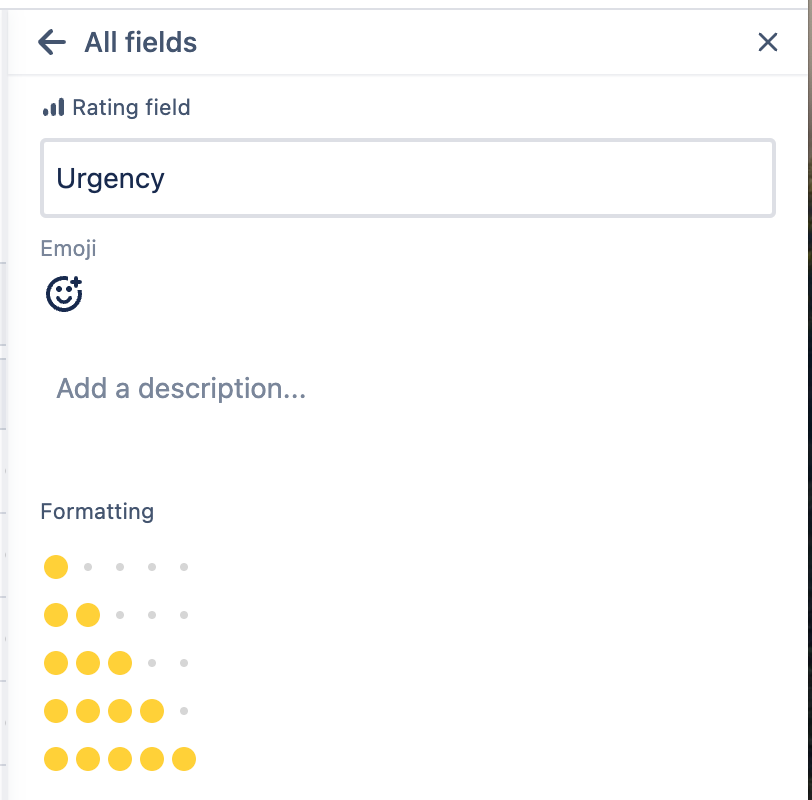

The field is not of type Urgency, it is a "Rating field". And I cannot figure out what value options that field have, and I think that is the cause of the problem. I have tried "3" and 3. According to the documentation the field have value from 1 to 5.
Nick Haller
January 8, 2024
Hi @[deleted] ,
Thank you for the additional information. The format of a rating field is actually a number so to your point, quotations would not be needed.

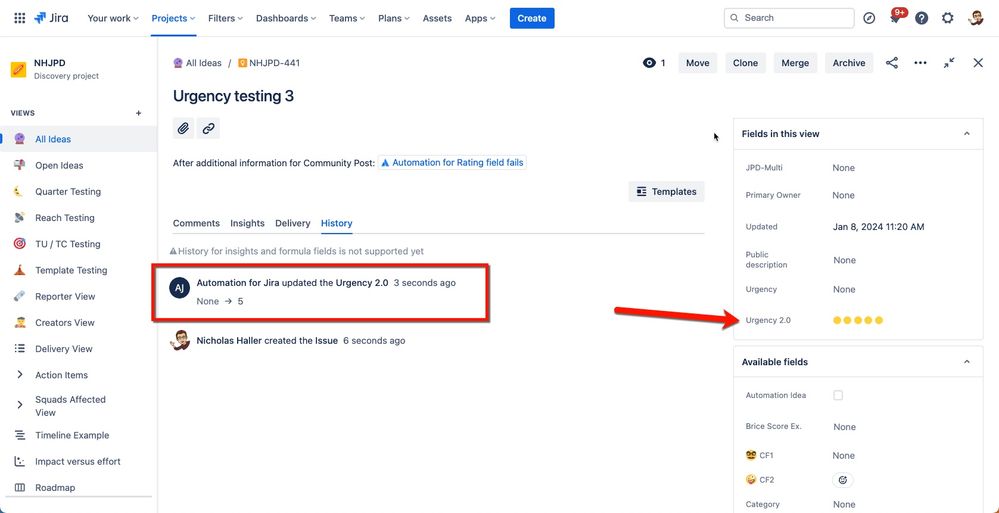

After an additional test with a similar custom field, I was able to get my automation working as expected with a body like this:
Where:
  • customfield_10263 = Urgency 2.0 (custom rating field)
  • JSON body is:
"fields": {
"customfield_10263": 5
Hope that helps!

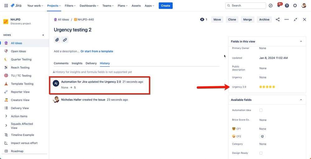

Nick Haller
January 8, 2024
Hi @[deleted] ,
Thank you for the additional information. To your point, a Rating field is a number field and does not need quotations like a value might.
I was able to test with a similar custom-Rating field, and adjust my automation's JSON body to get this working as expected:
Where:
  • customfield_10263 = Urgency 2.0 (custom-Rating field)
  • adjusted JSON body:
"fields": {
Hope that helps! If you continue facing the same error, feel free to reach out to JPD support.
