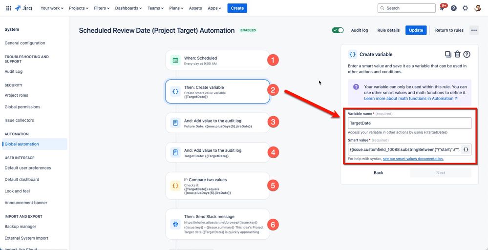

Having said that, I think your use case may still be possible if we manipulate the JPD date-field through smart values, and compare it to a date or another field. Below is an example of this.
1) WHEN: Scheduled (select when this automation should be scheduled to run)
2) THEN: Create variable
  • Variable name = TargetDate (or anything you like)
  • Smart value =
{{issue.customfield_XXXXX.substringBetween("\"start\":\"","\",\"end\"")}}
  • ^ customfield_XXXXX would be the custom ID of your JPD date-field
*3 / 4) These steps can be disregarded, and were simply used for logging purposes to troubleshoot and debug throughout testing
5) IF: {{smart values}} condition (aka "Compare two values")
  • First value = {{TargetDate}}
    • ^ This would be the variable configured in step 2
  • Condition = equals
  • Second value = {{now.plusDays(5).jiraDate}}
6) THEN: Send Slack message (or email user(s) / preform some other action)
Step 2 converts my JPD Project target field from a range, into a variable with the formatting of yyyy-mm-dd. This is done using string processing.
Step 5 then compares the variable to the present date + 5 days from now (future date so to speak), and if these two dates match - the automation sends a message to Slack.

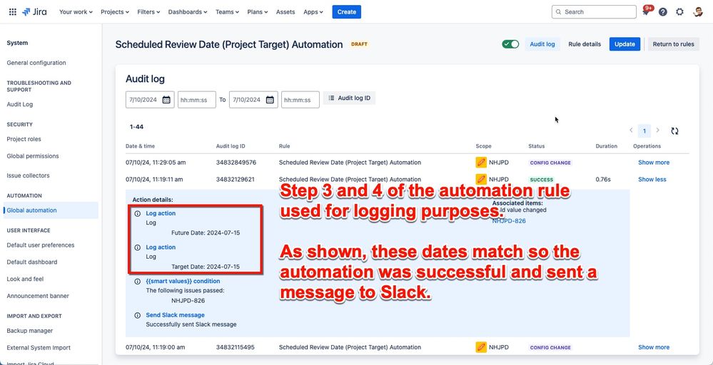

Here is the Audit log tab of this automation through some testing:
I'm not sure this is the "perfect" way to do this, but I hope it helps and can reference when configuring your automation!

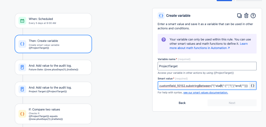

Hi Nick,
I've tried it, and it's not working. I've used the log and it shows as attached.
maybe the smart value format is missing something?
{{issue.customfield_10152.substringBetween("\"start\":\"","\",\"end\"")}}

Hi @Sahar Qarem ,
It would be very helpful if you could post the log action result of the custom field "{{issue.customfield_10152}}". This will allow us to see the value structure. The next step would be to process this value using automation smart values to extract the information you need.

Hi Alaa,
I've logged it and getting the same and Project Target above, (no result, empty)
I've executed the JQL below:
Project=XM AND "project target"~"2024-07-12" ORDER BY cf[10152] DESC, Created DESC
Where, "Project Target" is the custom field used in "order by" as well.
How can i search JQL using smart values?
