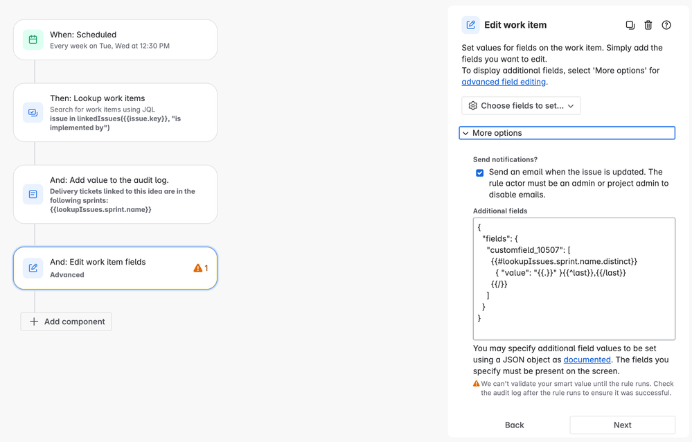

Here is the configuration of the automation:Screenshot 2025-07-30 at 1.32.17 PM.png
This is just for the one-time batch update and testing the automation (I have a separate one that's triggered by any change in the Sprint field in the delivery tickets)

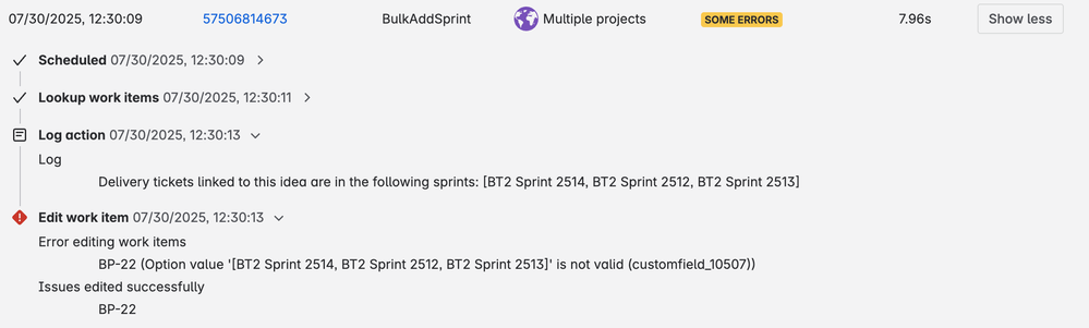

This is the error that I'm getting:Screenshot 2025-07-30 at 1.38.30 PM.png

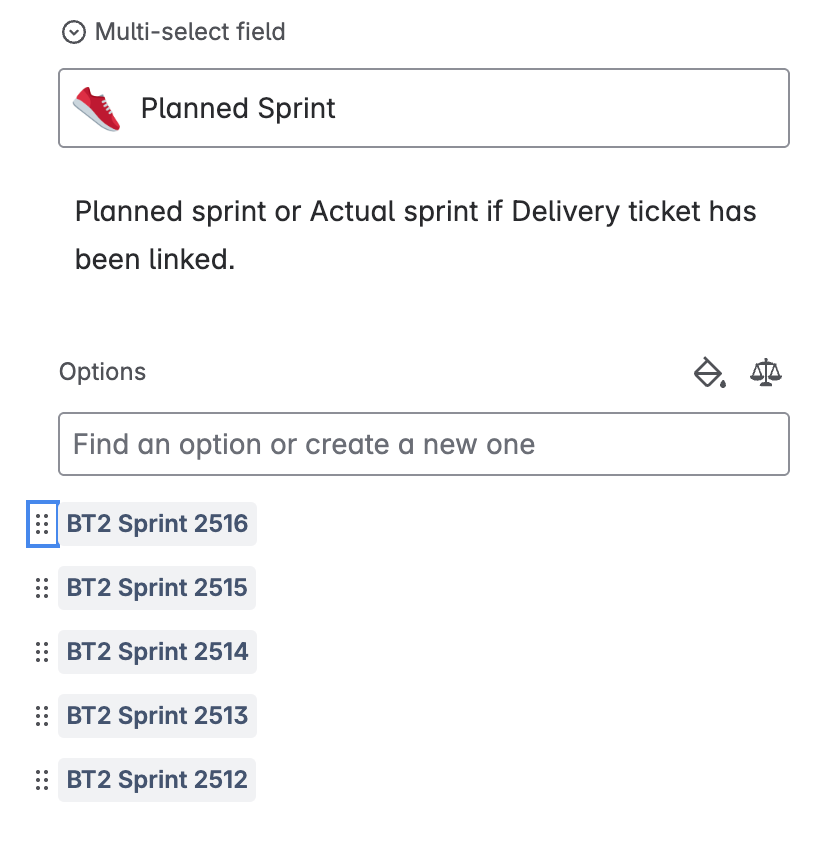

And, yes, I've verified that the field has all of those as options in the multi-select field dropdown (and I've verified that it works if I only pass one value, it's only an issue when I pass multiple)Screenshot 2025-07-30 at 1.40.51 PM.png

Earlier I noted the need to parse the Sprint values found, by work item, in the Lookup Work Items results.  This is necessary because...
  1. When a work item does not complete in one sprint, it might carry-over to the next one.  And thus another question is: which sprints do you want to select for the Idea's field?  Let us assume it is only for the current, "active" sprint for each work item.
  2. The Sprint field is a list of values (e.g., as noted above for carry-over).  Even when a work item has only been in one Sprint, that is a list of one item.  And the lookup result is a list of work items.  Thus, we have a list-of-lists that needs to be parsed.
Let's put those two concepts together using the Created Variable action to help:
  • trigger: scheduled
  • action: lookup work items
  • action: create variable
    • name: varActiveSprintNames
    • smart value:
{{#lookupIssues}}
{{#sprint}}
{{#if(equals(state, "active"))}}~~{{name}}{{/}}
  • create variable
    • name: varDistinctSprintNames
    • smart value:
{{varActiveSprintNames.substringAfter("~~").split("~~").trim.distinct.join(", ")}}
  • action: log, to see the distinct list
distinct active sprint names: {{varDistinctSprintNames}}
  • action: edit work items... use {{varDistinctSprintNames.split(", ")}} as the source for your iteration to update the field
"fields": {
"customfield_10507": [
{{#varDistinctSprintNames.split(", ")}}
{ "value": "{{.}}" }{{^last}}, {{/}}
Please try adding the additional actions and revise the edit to test the changes.
