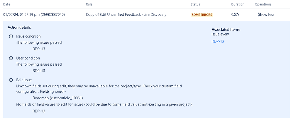

No matter the automation rule setup I try, I always get this error:
Edit issue
Unknown fields set during edit, they may be unavailable for the project/type. Check your custom field configuration. Fields ignored -
Roadmap (customfield_10061)
No fields or field values to edit for issues (could be due to some field values not existing in a given project):
RDP-13

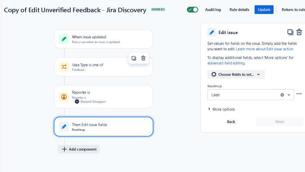

It's not what I want to accomplish but I went for the most basic setup to see if that could work, where I use the standard JDP field 'Roadmap' which is available without Advanced Fields, and i select the value Later
But this also throws the same error.

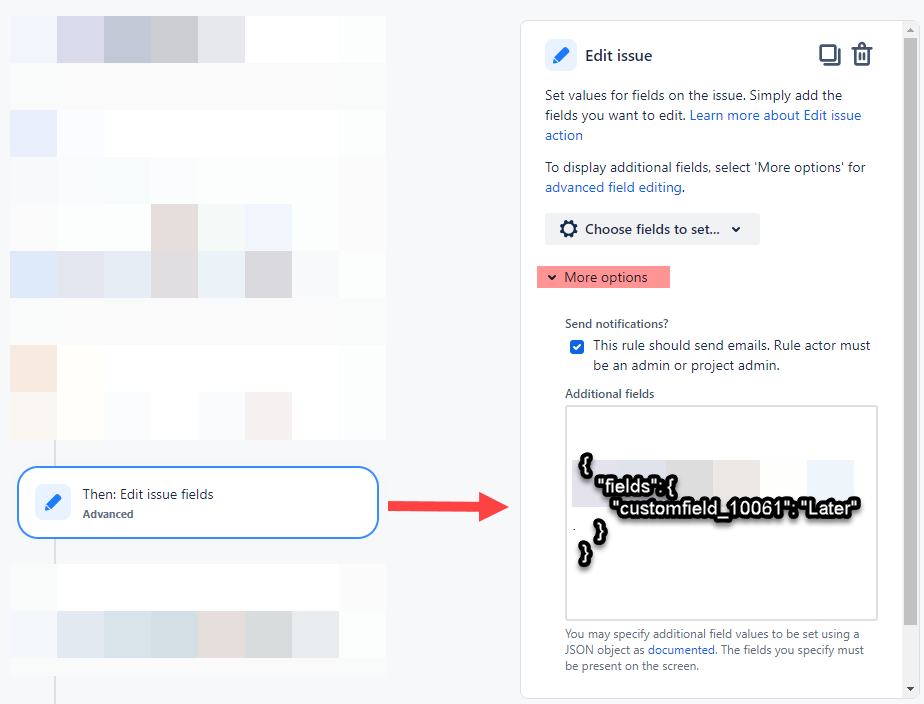

For some fields, JPD Automation can only edit that field when referencing to the custom field ID. Even though Jira created this field "out of the box", it still treats it as a custom field (hence not referenceable by its default name).
You should add the following JSON to the field that appears when you select "> More options" on the "Edit issue" action. Do not select any field in the "Choose fields to set..." button.
"fields": {
"customfield_10061": "Later"
 Example:
Hope that works - let me know!

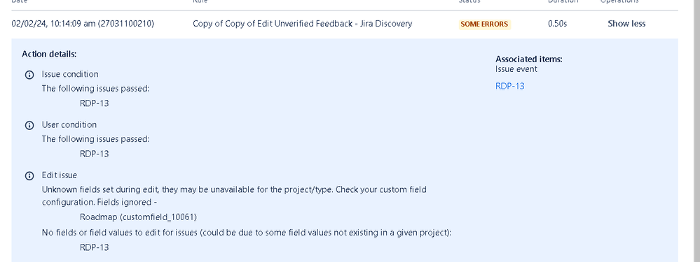

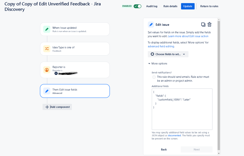

Hi @Mart Postma I still get the same error:
Another member posted a comment that they could select Roadmap and the automation worked for them.
Bug?

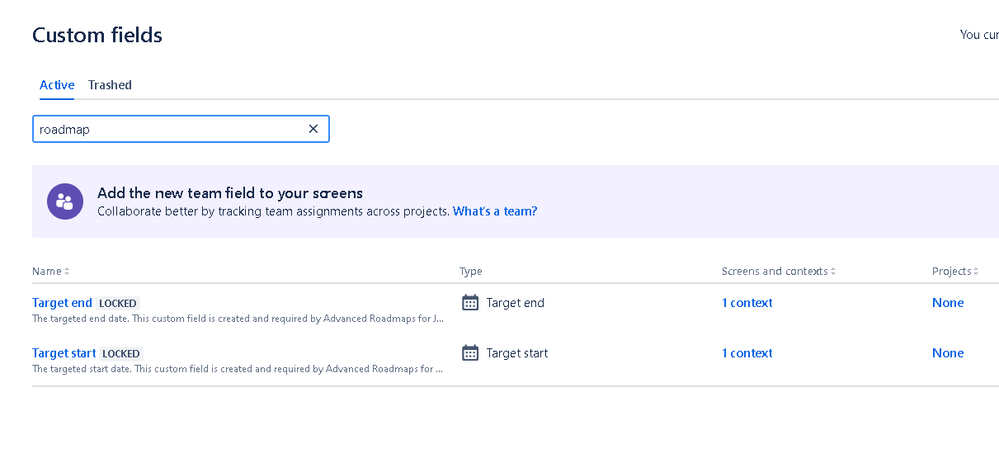

Have you checked your JPD project, and Jira site, to determine if there are multiple fields named Roadmap?
If so, you may need to rename the other one, or use an advanced edit with JSON using the correct custom field id to set the value in this rule:

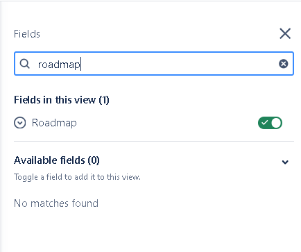

Hey @Bill Sheboy thanks for the answer.
This is the only roadmap field both in Discovery as Jira Software:

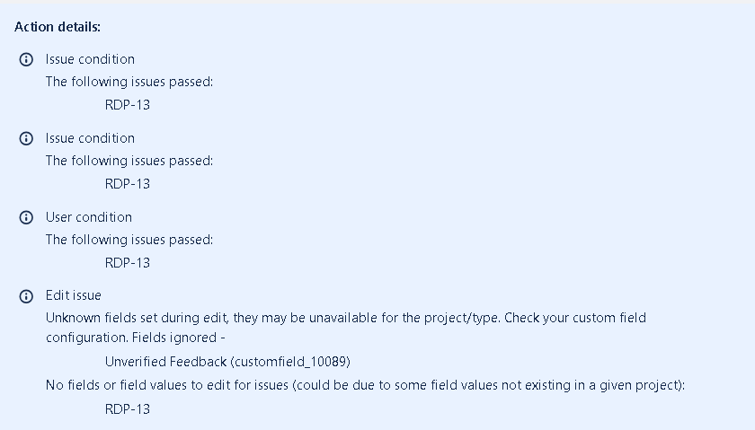

I also have an automation with the same error where I name the exact field:

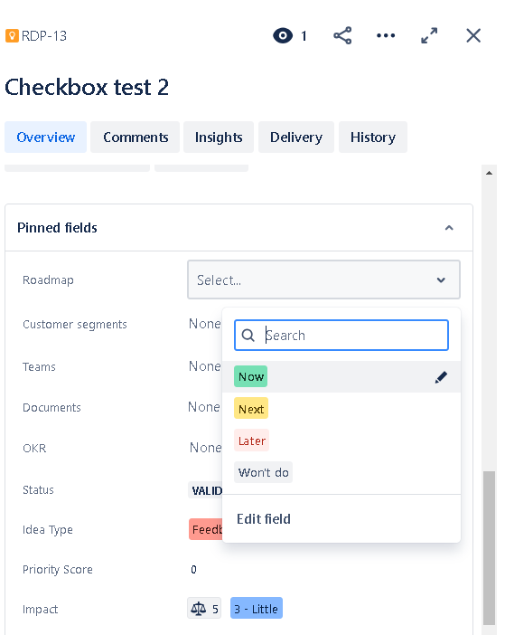

@Viktoryia K_ this is a standard/default project field that is already added to the sysem when you enable Jira Discovery Project. It is used in the project and also available as a field on the edited Idea that was to be triggered.
I looked at the screens settings but this is a Jira Software setting right? Not a Jira Discovery setting? It only shows issue types and fields that you have in Jira Software not Jira Discovery.
