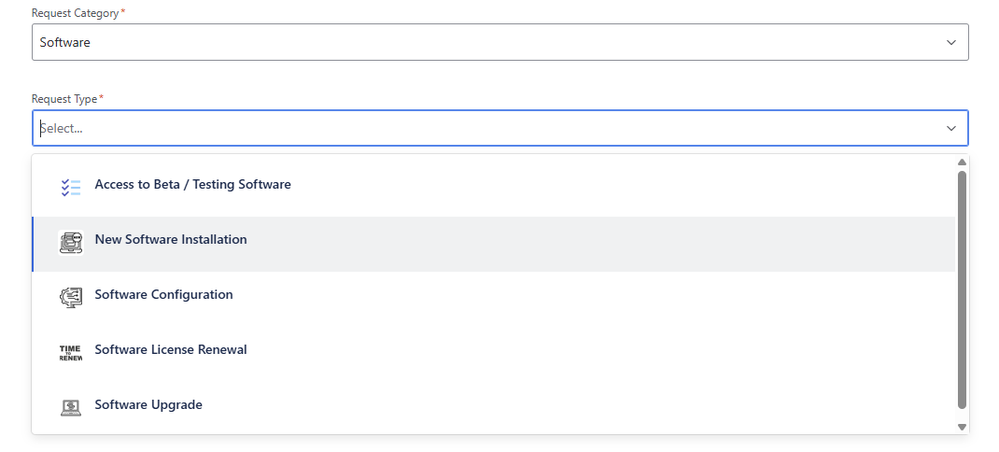

Could this not be achieved with JIRA Assets fields? I've recently done a implementation which leveraged the Jira Assets field for each of the request categories .i.e Software, Hardware,  then another assets field that populates options based on the request category selected .i.e. request new software, or LAN/WAN issue .etc

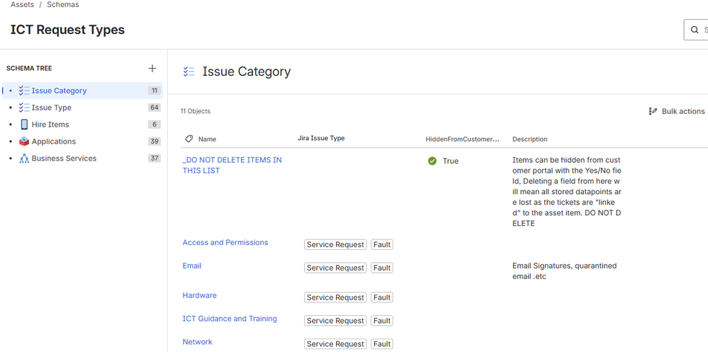

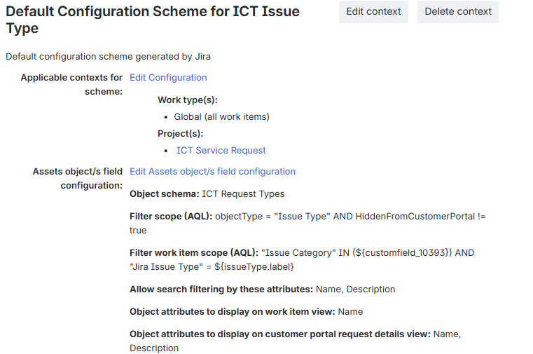

In this solution you would only need to custom fields for the two datapoints you are trying to collect per issue, then you would generate a schema in Jira Assets that has all of the possible options you are looking for, you will need some custom JQL to define the filters for those two custom fields, I've also based in the capacity to filter our assets I've labelled as hidden on customer portal.
The one thing to keep in mind with this approach, is if you care about retaining the datapoints and want to make changes to the options in the future, Don't delete the existing assets as that will also remove any linked tickets from that deleted asset, instead implement a hide solution as I have done.
