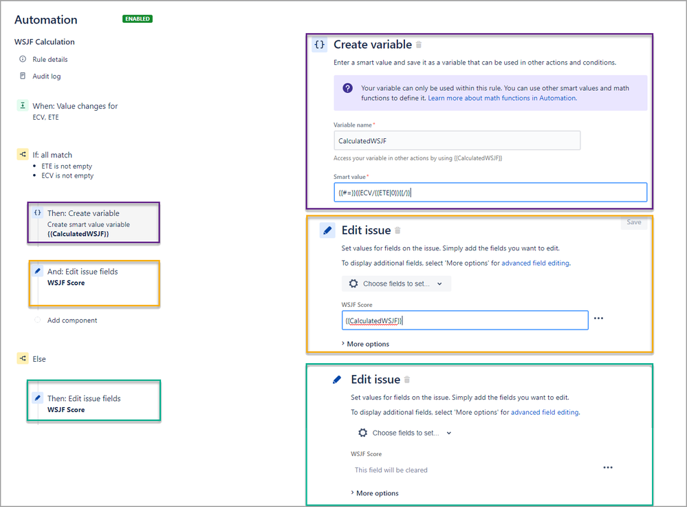

I added the required new fields to my Jira project and created the automation rule based on your suggestion to calculate WSJF score. Unfortunately, the score is always showing as "0". Also, while the audit log indicates success, the test ticket I'm using shows "No automation available" under the Automation section. I'm hoping you might be able to provide some guidance. This is my first adventure using Jira Automation and I fully expect I'm doing something particularly stupid but I'm a bit too much of a newbie to realize what that is!
My rule is currently quite simple as well. Instead of calculating a business value by adding together the 3 fields in your example, we decided at this early stage to just input what we call an ECV (Estimated Customer Value) score directly via a drop-down selection of Fibonacci numbers. The other input field is our our preexisting ETE (Estimated Total Effort) field which is our version of the "Size" field in your example. I've added the Fibonacci numbers to this field which already contained "Small", Medium", and "Big". To keep things simple, for my initial rule creation attempt, I did not yet build in the suggested logic to handle representing values for these string selections. I am only testing right now by selecting numbers.
When I select values for either the ECV or ETE fields in my test ticket, I get a popup that seems encouraging "Issue updates available! This issue was just updated by an automation rule. Please reload to see the latest changes." but as stated, under the Automation section of the ticket "No automation available" is showing. The audit log for my rule is showing that 1) The rule is enabled, 2)The IF Block Passed and updated my issue. 3) The WSJF Score field was updated with the variable {{CalculatedWSJF}}. However, the WSJF score shown in the updated ticket is always '0".
What follows is a single screenshot of my rule which I edited so you can see the all the details as once - Create Variable and Edit Issue in the If Block and the Edit Issue in the Else block.
I would be grateful for any insights you may have about what's not right.
Doug
Colton_Kosicek
February 22, 2021
Hey Doug,
For some reason i cannot see your post here but this commentary may help others so i'll post it.  When i provide the following
"Smart value = {{#=}}{{CalculatedBusinessValue}}/{{Size|0}}{{/}}"
The Size|0 value is stating.. use the field "size" value and if it empty than provide "0".  Because you use a string instead of a number value you are always providing a "0" as the bottom number which will result in a "0" calculated score or an divisibility error.
My suggestion above with running some extra "IF" Loops for each of your values helps set Value for your string according to the assumed Fibnocchi score.  Multiple nested loops are never a great way to code but we are not coders so this could do.

Doug Shapiro
February 22, 2021
Hey Colton!
I'm happy you got the post notification with the details of what wasn't working for me. I posted it successfully on Friday and over the weekend found that the post was removed and have no idea why. I tried to post again on Sunday and I'm sure you got a second notification and again, when I refreshed this thread, the post was gone. I can't figure out why it's being removed. I'm not breaking any posting rules I know of in the text and likewise, I can't figure what would be wrong with the one screenshot I provided with the rule details. Very strange indeed. I hope this reply gets posted!
You are right about needing the string handling but I intentionally did not provide it for my initial attempts and in testing ONLY selected Fibonacci values in the drop-down for ETE yet I still always ended up with a WSJIF score of 0. I had a colleague take a look and he found that I was missing the curly brackets to close the "ECV" in my calculation:
Missing curly bracket after ECV:
{{#=}}{{ECV/{{ETE|0}}{{/}}
Corrected:
{{#=}}{{ECV}}/{{ETE|0}}{{/}}
My tests are now successful! (avoiding any string selections until I build in your suggested logic).
What throws me is why didn't the audit log flag ECV as being invalid in this calculation? I wouldn't have expected it to be valid since I never properly closed out the field name in the calculation!
Thank you very much again for helping. I will try the string logic next!
With much appreciation!!
Doug
