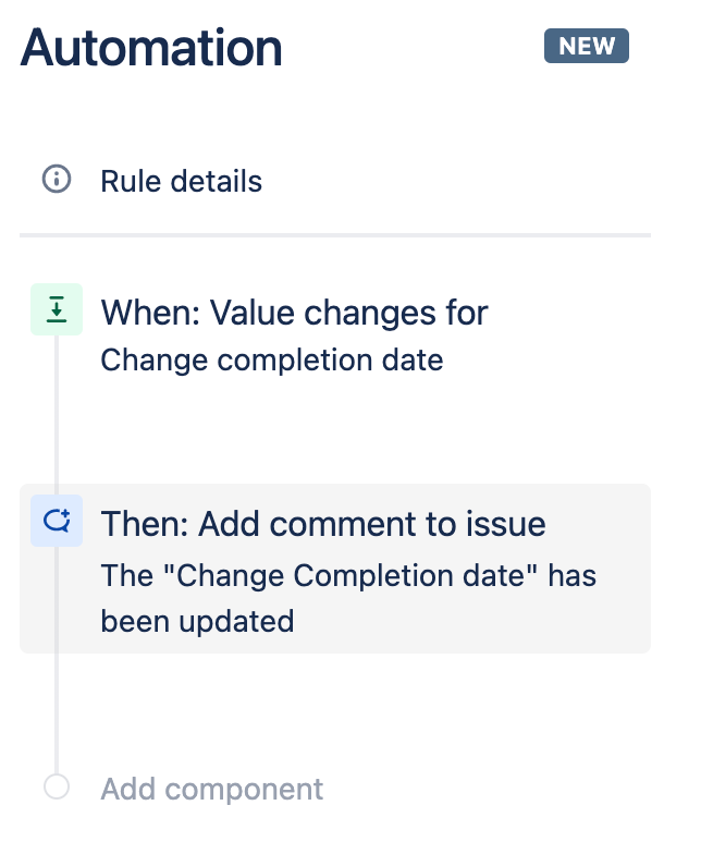

Darshan Mandhane
July 6, 2021
I am adding a screenshot of what I meant.
You may also write variable substitutions in the comment if you want to put the actually changed date timestamp.

Coby Fuller
July 7, 2021
@Darshan Mandhane Thank you for taking the time to respond. I had considered this and even had the rule created, but decided to remove the automation rule. I would like to for the teammates to get into the habit of adding a comment if they need to change a date. Automating a comment that they typically ignore just was not working.
