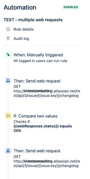

Hi @Johnny FromCanada
Would you please post an image of your rule structure (no need for the web request details) to clarify a bit?  It is unclear from what you are describing by "if-branch" and "if-block": is this a single condition or an if/else component.  So the scoping of the symptom you describe may be a factor.  Thanks!

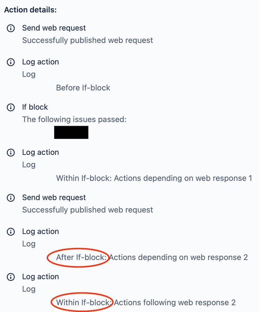

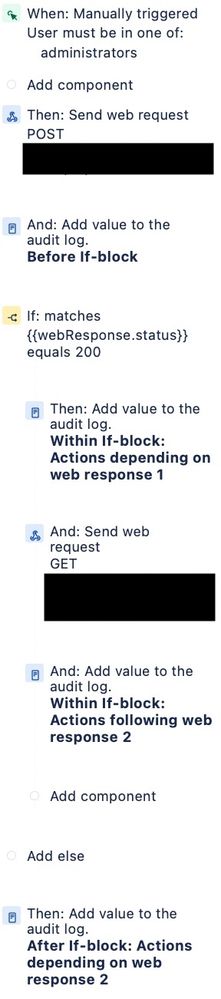

Johnny FromCanada
November 12, 2021
K, I have added screenshots of a base-case rule and audit log.  I have also edited the text to replace the confusing "If-branch" terminology with "If-block".
The action after the If-block runs before the remaining actions within the If-block (after the second web request).
This behaviour is highly reproduceable.  It does not matter whether the web request succeeds or fails.  It does not appear to be an anomaly of the logger (say being asynchronous), since any kind of action gets out of order (not just log actions).
My guess is that the web request fires, spawns a new thread (to wait for the web response), and yields to the main thread, which continues executing (after the If-block).
Like # people like this
Bill Sheboy
November 15, 2021
Thanks for that additional information, @Johnny FromCanada
In my experience, even the writes to the audit log do not consistently appear in the order of writing, so they cannot be relied upon for diagnostics of flow.
As you show your rule using the "wait for response", something seems odd.  If you are on a paid license, I suggest working with your site admin to submit a support ticket to Atlassian here: https://support.atlassian.com/contact/#/
They have access to logs we do not, and may be able to uncover what is happening in the flow.  When you hear back, post what you learn here to help the community.  Thanks!
