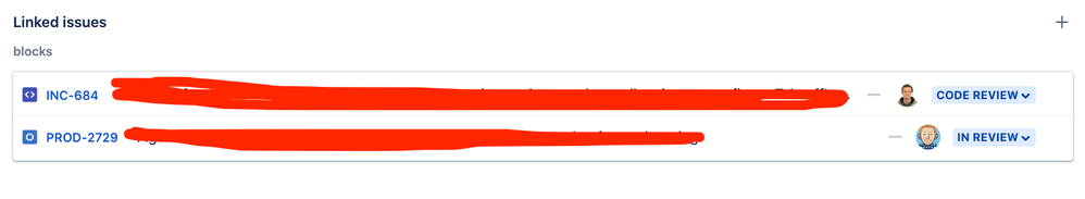

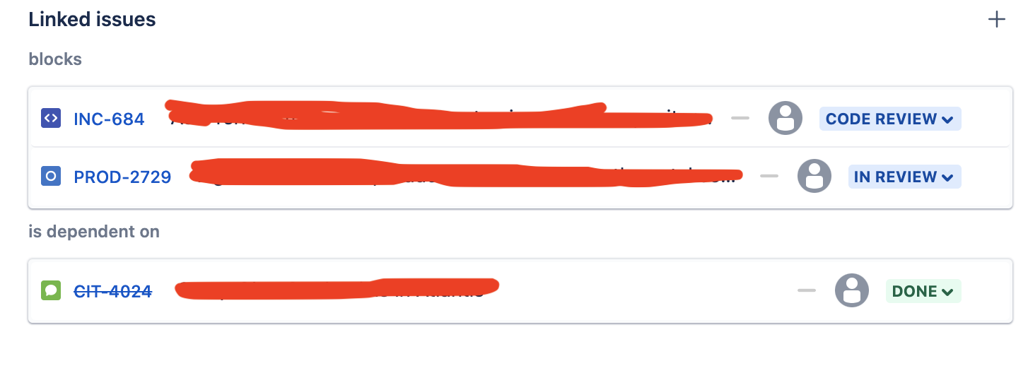

Hi all, I wonder if you can advise.
Our Service desk is set up so customers can only view things via the portal (including internal teams).
We would like to be able to use the linked issues functionality to link Service desk issues to other software projects as they are dependent on the service desk item.  Although people are added as request participants they cannot see the linked issue.
If we add the portal link via a web link they can see it.  Is there a way we canuse the linked issue functionality and have the link go to the portal?
Hope this make sense
What I see (Jira Admin)

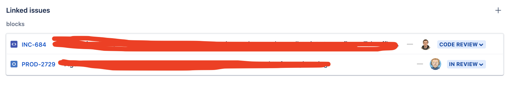

What the request participant sees

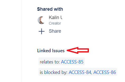

Hi, Lynne. As other members have pointed out, there is no out-of-the-box solution from Atlassian. You may vote and start watching https://jira.atlassian.com/browse/JSDCLOUD-4636.
You should look for a Marketplace app or make use of Jira automation and update the Description field with the related links every time the issue transitions to a status (or any other trigger that works for you).

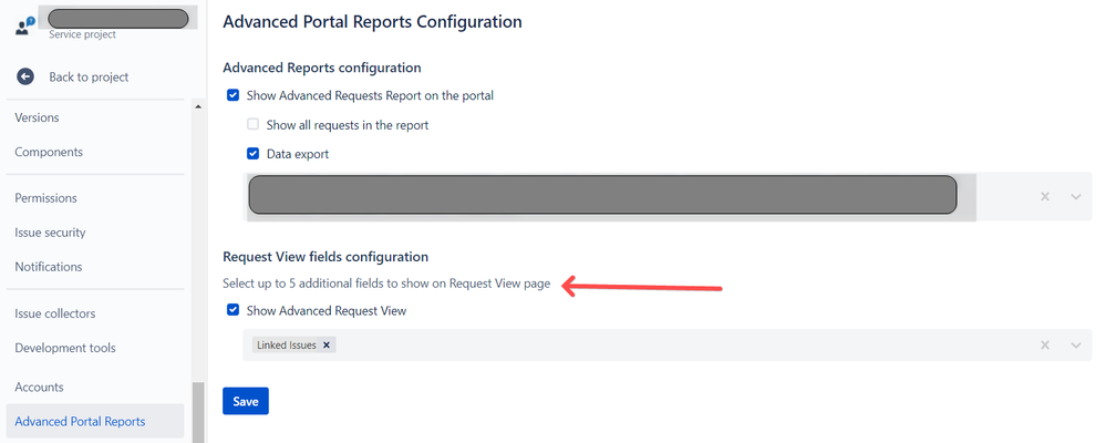

You may use Nemetschek's Marketplace application Advanced Portal Reports for Jira Service Management. It allows you to expose certain Jira fields to service desk customers:
This should display these links on the customer portal:
The links would open in another tab, still in the customer portal, and only if the user has access to the project and the specific issues (tickets) either as an agent (Jira SM or Software user) or portal customer (shared ticket).

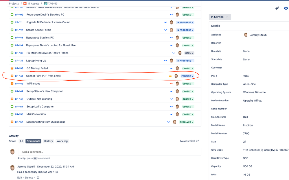

As far as I know, there's no out of the box solution for this.  I have accomplished this with an add-on by Deviniti Extension for Jira Service Management.
Like # people like this
Lynne Ratcliffe
April 19, 2022
Hi jeremy, thanks for the tip.  Does this work the other way? i.e. the Service desk issue shows as a linked issue in linked issue project.  My screen shots are from the Jira software project and as Jira Admin, I can see it but the person added as a request participant cannot see it there.
Jeremy Steuhl
April 19, 2022

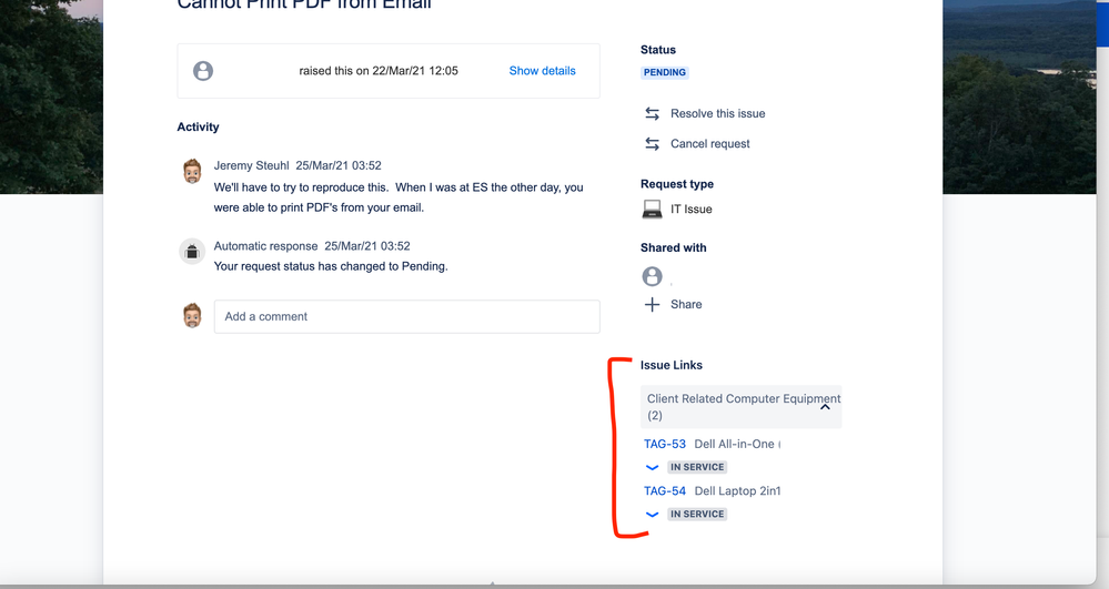

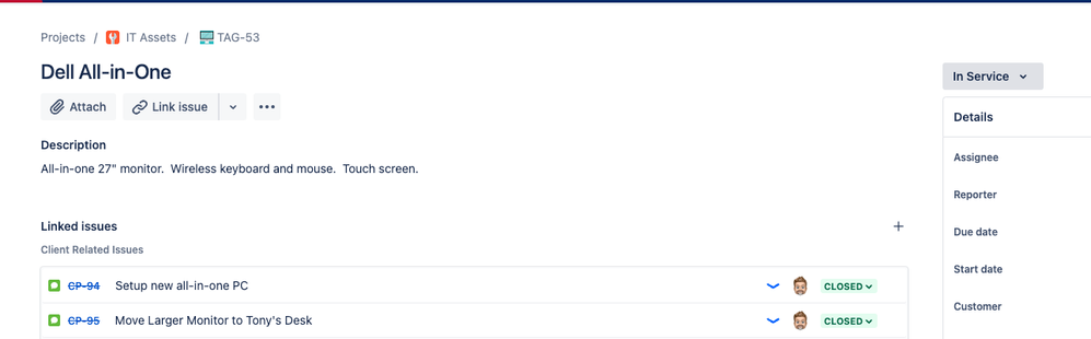

Hi Lynne,
Yes, once it's linked, it shows up in the technician interface on both projects.  That's Jira out of the box at that point.
Here's a couple of screenshots of my example that I noted in my original comment, where the SD issue is linked to non-SD issues.  In this example I have my IT Service Desk project linked to a SW project called "IT Assets".  The customer will not be able to drill down into the SW issues associated with the service desk issue, unless they are a jira user and have access to the SW project, but they can see the issue key and summary.
