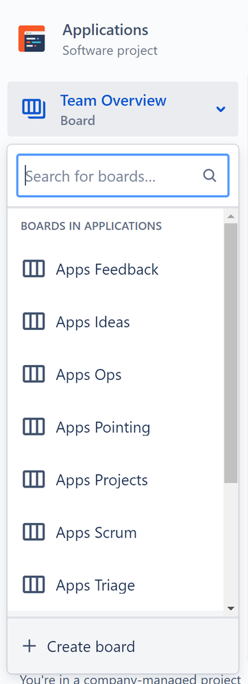

In addition to using multiple epics, labels, components etc... to allow you to better organize the tickets within the project, I would also recommend different boards within the project.
You can setup each board to have a different JQL filter, showing only the tickets you want on each based on label, component, assignment or a combination of properties.
  • Product Managers get a list of epics
  • Product Owners get a list of tickets to epics to which they're assigned
    • filter one for tickets still needing user stories and acceptance criteria
    • filter another for tickets that need pointing
    • filter another as the 'ready' for scrum backlog
  • Scrum Teams can each have a scrum board with relevant ready work and the current sprint work
The combination of Epics (~50) and Boards (~10) makes our 2000+ ticket project manageable at scale

Oliver Vistisen
July 15, 2021
Depends on which project type you're using in JIRA, but if it's the classic company-managed type you can create a new board from the board selection menu (see below).

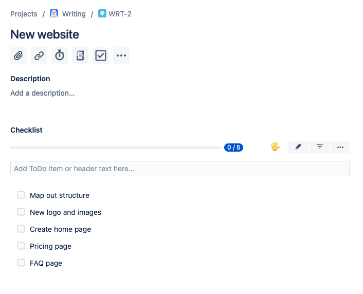

Depending on the volume, you might want to consider starting with a single issue to represent an epic with a checklist on the issue (note that I’m part of the Issue Checklist for Jira team) to capture the stories. This is useful if you have lots of Epics and are unlikely to get to one/some of them for several months. The checklist gives you a place to keep the story ideas without cluttering your backlog. Then when you’re ready to develop the functionality, you can create an Epic and an issue for each item in the checklist.
Ethan
July 15, 2021
I like the idea of 'not cluttering the backlog'.
However, I am have trouble trying to work out what you meant by "starting with a single issue to represent an epic with a checklist on the issue (note that I’m part of the Issue Checklist for Jira team) to capture the stories." Can you please clarify?
Jennifer Choban - HeroCoders
Atlassian Partner
July 16, 2021
Sure. Let’s say my company is planning on building a new website, but we’re probably not going to start on it in the next few sprints. I could create a New Website Epic with issues for each task needed (decide structure, source images, make home page, pricing page, etc.).
Alternatively, I could create one issue called New Website and store the list of tasks as a checklist. All of the information is preserved, but it is only taking up the space of one issue. Later, when I’m actually ready to begin work on it, I can create a new Epic and can create individual tickets from each of the checklist items. It just gives you a way to keep the number of items that are in the backlog at one time from getting out of control.Epic.png

Ethan
July 18, 2021
@Thank Jennifer.  Appreciate the explanation.  I will try out a combination of some answers from above and yours to work out what will work for our Sprint Active Board view.
