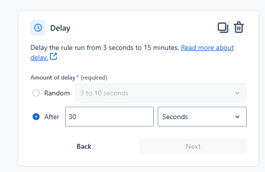

Urmo
April 23, 2025
In Jira Cloud Automation have Delay option to set how much time it should wait before run.

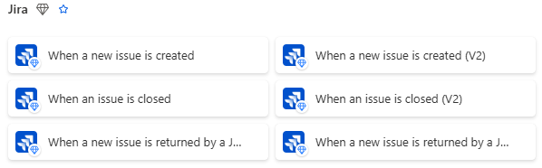

chad.leblanc
April 23, 2025
I've used Power Automate to create new stories in Jira - not sure if that's the app you're using, but depending on what your process is doing, there may be a small triggering effect there that could fire another flow here, to start another flow simultaneously
Here are some of the available triggers I can see (may differ for everyone)
