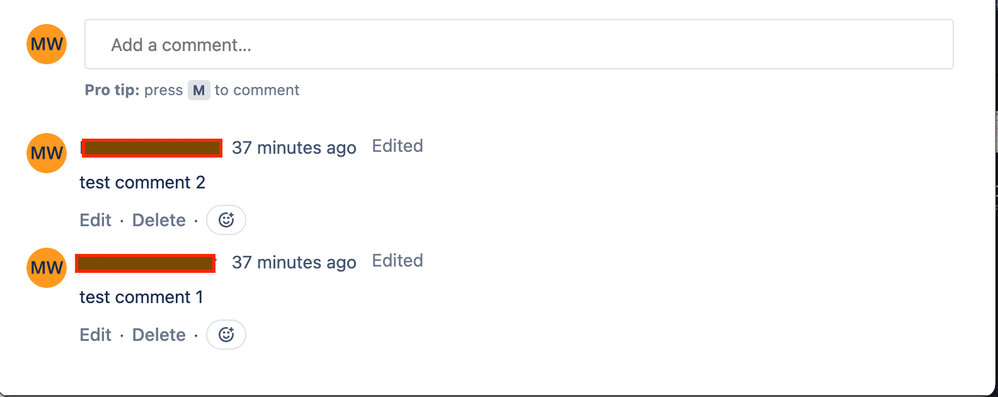

Mangesh Waikar
July 13, 2023
does anyone know how to link comments in a jira ticket to a smartsheet?
Additional Information - i have a jira connector established between SS & Jira where information flows bi-directionally. While setting up the connector, i was able to map all the fields except for the comments posted within the jira ticket. Any idea how this can be done?
Example - as per the below screenshot "test comment 1" and "test comment 2" should get updated in smartsheet automatically
