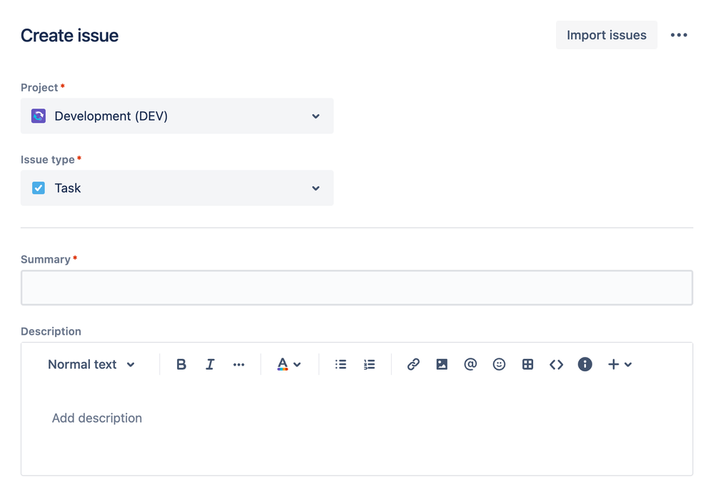

Instead, I was hoping to display the new description field on this screen, similarly to the new create issue experience that supports the WYSIWYG editor:

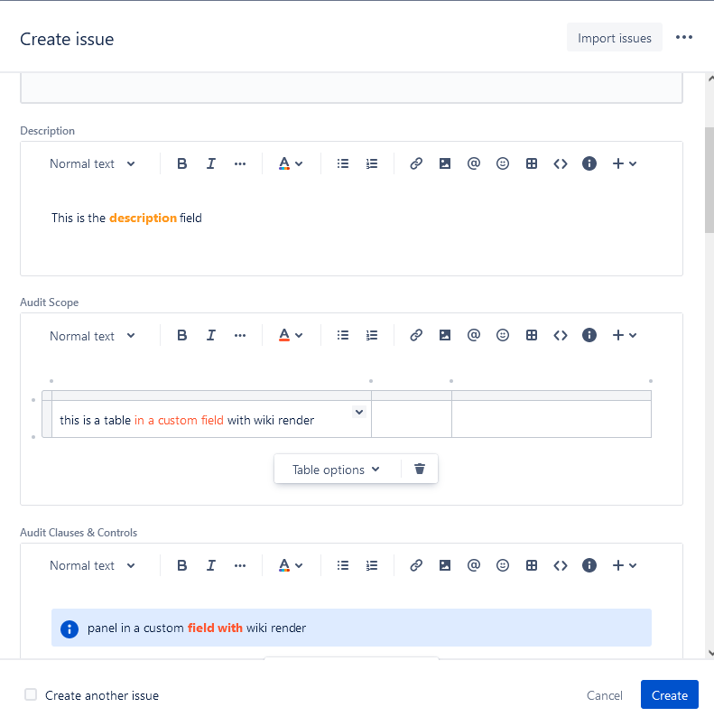

Interesting cause all my large text fields with wiki rendering display the WYSIWYG formatting
Like Amir pointed out it's only for large text fields and you have to set the render type on each field you want to use wiki rendering

Although in your case, I can see that the WYSIWYG renderer is available on the Create screen, which uses the new create issue experience. While on other screens, assigned to workflow transitions, the formatting options different.
