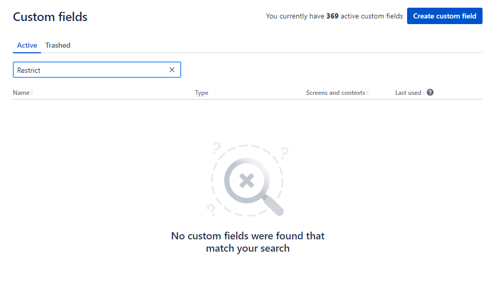

"Restrict to", as a custom field, can be hidden away from projects with the context or the field configuration.  What exactly is stopping you from doing that?
Like # people like this
Sergei Gridnevskii
August 24, 2021
There is no Restrict to field when I search it in Custom fields. I think it is a standard Jira field.

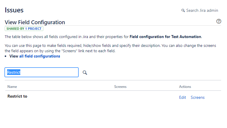

The comment in the configuration is that this is required for Test Automation - I'm assuming you have a test automation plugin? So, if you remove it the plugin will cease to may stop working. If you click on shared by 1 project you can see which project is using it and if it is still required.

Well I tend to agree, I think this field was added by some plugin. Is there a way to restrict plugin to certain projects so that it does not interfere into normal work of Jira? And the second question - is there a way to find which plugin created the field so that I would uninstall it or write to developers to fix it?
Linda Milne_Togetha Group_
Atlassian Partner
August 24, 2021
I don't believe you can restrict plugins per project, as such - you can use groups or other config to restrict user access to it.
Ive just had a look at my field configurations and I too have a Restrict To config in one instance, but not the other. Cant identify what plugin it might be linked to. Is it an Access / SSO thing? The big difference between the two instances is the Microsoft Teams plugin - could that be the source?
