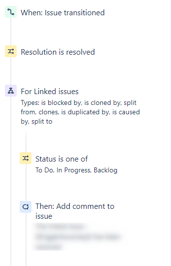

If all your issue are linked i think you can do this kind of automation (just replace "add comment to issue")
i think this should work

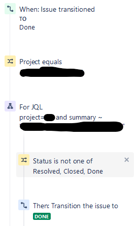

I would do this with a Global automation. Note that you need to be a Jira admin.
The trigger would be the transition of the project ticket to status=Done. And then I would use the Branch rule / related issues. If the project ticket and the service desk tickets are linked with a specific link type, then I would use the For linked issues as Arnaud Courtoisier shows in the example. Another way is to use the JQL option and enter the query that would return the service desk: e.g. project=<service desk project> and <field>=<some field>
In the example below I use the fields Project and the field summary, but you can update that to be anything that will return your service desk ticket.Screenshot 2022-02-01 072937.png

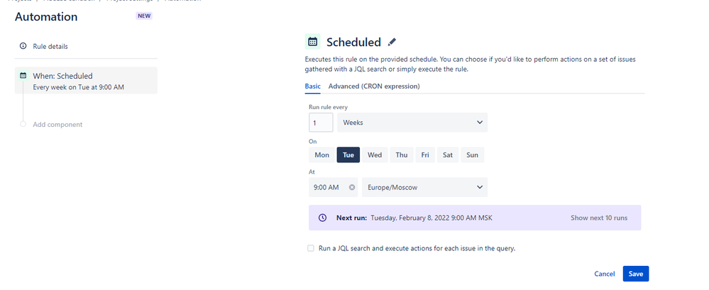

sergei_lavrov
February 1, 2022
I meant to schedule an automation rule sorry:
