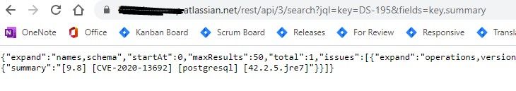

That's strange, because I put your summary into one of my tickets and when I run an API call, the result is shown below
I don't believe that square brackets are reserved or are a problem at all - are you getting other summaries coming through in full, but the one that has square brackets is null? What language are you using? Could your code be causing the issue?

For the ticket which is giving you the blank summary, if you put the following into your browser where you're logged in to Jira in another window, what do you get?
https://CoName.atlassian.net/rest/api/3/search?jql=key=ABC-123&fields=summary
where CoName is your company's name in the Jira URL and ABC-123 is the key of the ticket that shows a blank summary
https://abc.com/rest/api/latest/search?jql=key=ABC-123&fields=summary
this works for me
While debug i am getting the same response but while fetching in my code i am getting null.
Right, so that means that the API is correctly returning the summary.
I have no idea why your code isn't getting that summary, you'll need to try and step through the code to understand it.
