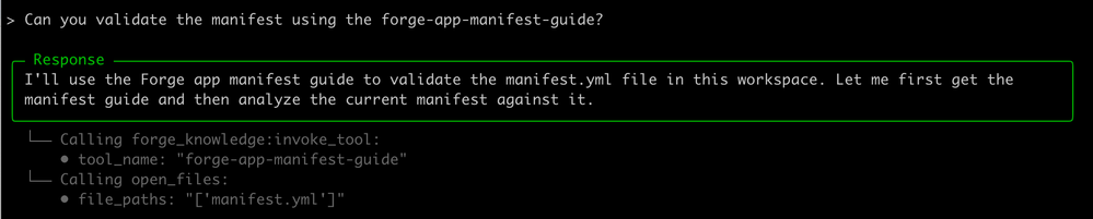

I just did some tests and I didn't run into any issues.
As an example, I've tried to validate the manifest in the folder of an app using one of the tools included in the Forge MCP Server. I used the `forge-app-manifest-guide` tool (more on this later).

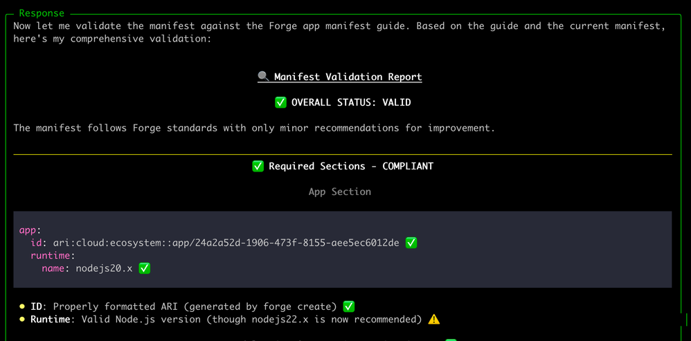

And the validation continued:
Maybe you could share some screenshots or some more details about the question you've been asking to the Rovo Dev CLI.

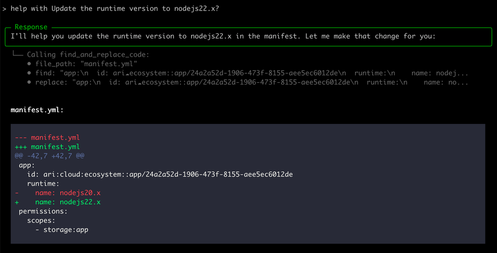

The reason I chose the option above is also to test the feedback from @Darryl Lee regarding the node version.
If I use it today, the Final Verdict is pretty clear about suggesting upgrading to nodejs22.x.
I then continued asking to update the node version and it did the change to the code. Note that this is calling the "find_and_replace_code" which is provided by the "filesystem-tools" MCP server and not the Forge MCP one.

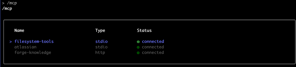

Notes about MCP servers and tools available in the Rovo Dev CLI
It might be good for me to share here how to check the MCP servers available and their tools in the Rovo Dev CLI.
Enter /mcp to check the available MCP Servers
Select the MCP Server and continue to view the related tools
