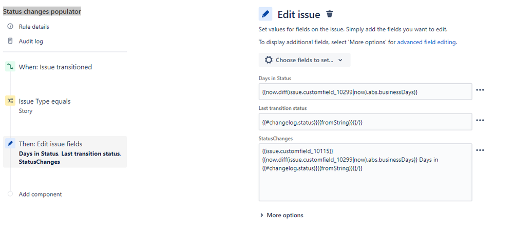

For the automation
Using {{#changelog.status}}{{fromString}}{{/}} to provide the previous status
As well as updating the Days in Status field using:
{{now.diff(issue.customfield_10299|now).abs.businessDays}}
At the same time the StatusChanges field is updated:
  • The {{issue.customfield_10115}} part of this copies the existing content of the field back into what is otherwise an overwrite of the fields content.
  • {{now.diff(issue.customfield_10299|now).abs.businessDays}} is a copy of what is going into the “Days in Status” field, but making it visible.

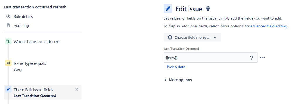

I then created a 2nd automation rule set to run after the 1st Rule. It simply refreshes the Last Transition Occurred field for that issue, so that it is ready for the next Status changes populator (the !st Rule) run and can record the transition so that the  {{now.diff(issue.customfield_10299|now).abs.businessDays}} is accurate.
The net result being a paragraph field that updates in real-time, the journey of each issues Status changes as measured in business days.

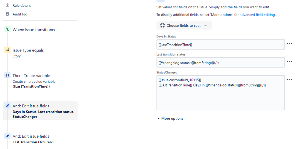

It looks like each transition adds a new line to the text field - is that correct? So if an issue transitions back to a previous status, then that status will be mentioned again. Do I have that right?
I'm also wondering why you ended up needing the second rule. My intuition suggests that editing the issue twice didn't work properly, since you needed the "Last Transition Occurred" field in order to do the date computation. Or did you encounter something else?
For that situation, I was wondering if you tried saving that value early in the rule in a variable, so that you'd only need one "Edit Issue" component? Would that have worked to avoid the second rule?

All transitions are recorded and added in sequence to the StatusChanges field. Yes, the 2nd rule is simply a timing thing.
I like the sound of your variable suggestion and variables is one area of Automation for Jira that I haven't got to.....so I'm off to experiment now!!

STOP THE PRESS
Thanks @Mykenna Cepek for the variable inspiration. This is why I love this Community
By creating a variable {{LastTransitionTime}} out of
The 1st Rule can now do it all, by using the variable as follows and finishing the rule with the update to {{now}} on the Last Transition occurred field....job done in one automation rule.
