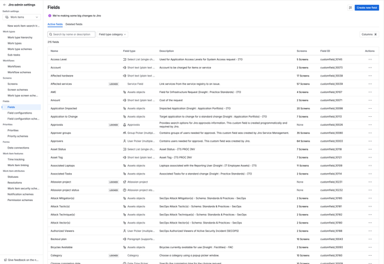

Hey everyone,
It’s me again, back with an update on all our field improvement initiatives. If you’ve missed my original post on all the changes we have planned, head here.
Let’s start with the highlights:
  • Fields management page is now live for everyone! (*unless you are on bundled release tracks)
  • This includes the following features
    • customising table columns
    • filtering by field type categories
    • seeing field IDs
    • creating and editing fields on the same page
Note, in the midst of all the changes, we had forgot to include that we are removing the ability to permanently delete fields after trashing. We've heard feedback that skipping the wait period was a source of data loss that's hard to correct and generally causes headaches.
For all intents and purposes, the field is removed from your site once you mark it for deletion, and if not restored after two months, it'll be gone forever. Please leave us any feedback or concerns around this in the comments.
Here are the next things we are working on:
  • Add field to field configuration schemes from the fields page (rolling out)
  • Support for third-party Connect/Forge created field types (soon)
  • Showing system fields (soon)
  • Sorting by field type (soon)
  • Searching by field ID (soon)
  • Manage field options when there is a single field context on the fields page
  • Support for fields created in team-managed projects (including JPD)
  • Update to the "Project" column to reflect field configurations (it is currently counted by company-managed project using screens the field is added to + team-managed projects association)
While I can’t promise exact timelines, the features tagged soon should start rolling out in 1-2 months.
Thank you for your continued engagement, please keep any feedback/questions coming!
