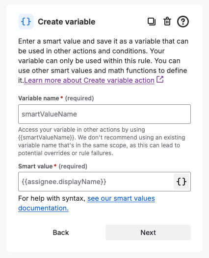

The easiest way to pull this value out, and store for future use within Jira Automation, is through the "Create variable" action. This action lets us create a new Smart Value / Variable in our automation execution, and populate it with the details of another smart value.
You can name the variable whatever you desire, it's the smart value field we need to focus on. You can choose whatever method described above to pull the date out. For later on, it's important to note if you store this as a date object, or a plain string.

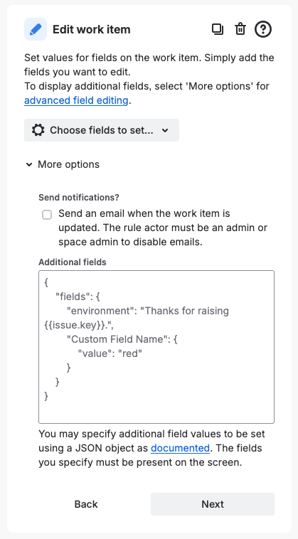

In addition, Jira Product Discovery date fields are not normally available as part of the standard fields listed in the "Edit work item fields" action, so we'll need to get a little advanced.
In the "Edit work item" action, there is an option for "More options". Expanding this menu lets you insert your own JSON to modify the fields on a given work item. This is where we need to get creative.
Here's the structure of the data we need to put in this field:
"fields": {
"customfield_54321": "{\"start\":\"yyyy-MM-dd\",\"end\":\"yyyy-MM-dd\"}"
Essentially, we're modifying a specific custom field, and giving it the JSON value it's expecting. Inside that are the two dates we need to provide.
What's great is this field supports Smart Values. So, all we need to do is input the variables you've created at the start into the field, and you're done.
If you're using variables called {{startDate}} and {{endDate}} this is what that might look like:
"fields": {
"customfield_54321": "{\"start\":\"{{startDate}}\",\"end\":\"{{endDate}}\"}"
As usual, make sure your custom field ID is correct!
Depending on if you've done any date math, you may need to use the .toString method to convert a date object into a string. Do some quick testing to ensure your use case is working properly, and you're off to the races!
