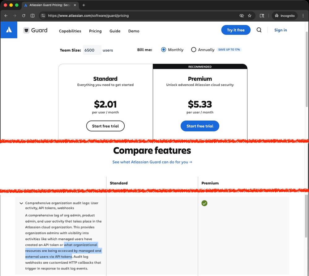

Atlassian also thinks providing access to API token usage in logs is a good idea too. They think it's such a great idea, they want to charge you an additional $4 per user (well, depending on how many users you've got, from $3-4) to upgrade to Atlassian Guard Premium.
Check it out below - it's an actual feature, but only if you PAY MORE.
This provides organization admins with visibility into activities like which managed users have created an API token or what organizational resources are being accessed by managed and external users via API tokens.
That's right. Atlassian has imposed limits on your system, and then wants to charge you to help you avoid hitting those limits. Huh.
So then. I think it'd be super-cool if Atlassian made that kind of logging part of Atlas Guard Standard. Or hey, here's an idea, how about not charging for it AT ALL?

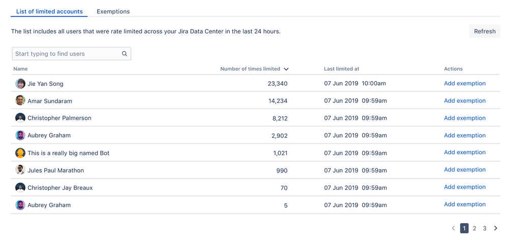

I went looking for some strategies on how to write scripts that handle rate-limiting, and found that (of course) on Data Center they have built out a dashboard and tons of controls that let you monitor and manage rate limits:
https://confluence.atlassian.com/adminjiraserver/improving-instance-stability-with-rate-limiting-983794911.html
Man, that's quite nice and based on that screenshot, the feature has been around since 2019!? So I guess if Atlassian ever wants to do things right on Cloud, they could uh, look at that for inspiration. (Alas, I fear that maybe the devs who worked on that feature may no longer be with the Company?)
