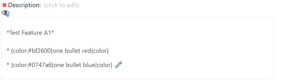

    • When the "Rich Text Format" field in the connector is set to "Jira rendered field" and you are using native Jira wiki render, then the Description and Acceptance Criteria fields containing Jira RTF will appear in Jira Align with an eyeball above them.Wki render eye.jpg
      • Clicking on the eyeball will open a pop-up showing Align's attempt to render the Jira wiki markup. It is similar, but not identical to what appears in Jira.

    • This is a less-than perfect solution to the fundamental issue of Jira wiki render being non-standard.
      • If someone inadvertently deletes, moves, changes any of the wiki markup character sin Jira Align then when the object syncs back to Jira is will look like junk and it can't be undone (unless you know the exact character or characters to fix).
