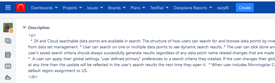

When our team members are creating Epics in JiraAlign (top screenshot), the description field is coming out badly garbled in Jira (bottom screenshot) and creating them in Jira seems to be doing the same thing in JiraAlign.

This is a known bug that has been open with Atlassian for many months and has to do with the difference in HTML Fabric Editors between Jira and Jira Align - they don't use the same one so it causes HTML tags to show up in either side and can definitely cause corruption issues.

I have noticed the same problem going from Jira Align to Jira but not in the reverse direction.
The field in question is straight text (and not multimedia) in Jira and when entered in Jira Align, the connector is not converting it but sending the marked up tagged version.

If your Jira environment is using "WIKI STYLE" Render for text - then the Jira Align setting under Admin - Jira Settings- Jira Setup- Field: Rich Text Format: must be "Jira Rendered Field"
If your Jira environment is using "Default text Renderer"  - then the Jira Align setting under Admin - Jira Settings- Jira Setup- Field: Rich Text Format: must be "Plain Text"
If your Jira environment is using a marketplace plugin for text formatting - then the Jira Align setting MOST LIKELY to help is Admin - Jira Settings- Jira Setup- Field: HTML -
*** unless you are using the exact plugin this option was built for this MAY NOT fully alleviate the problem*****
