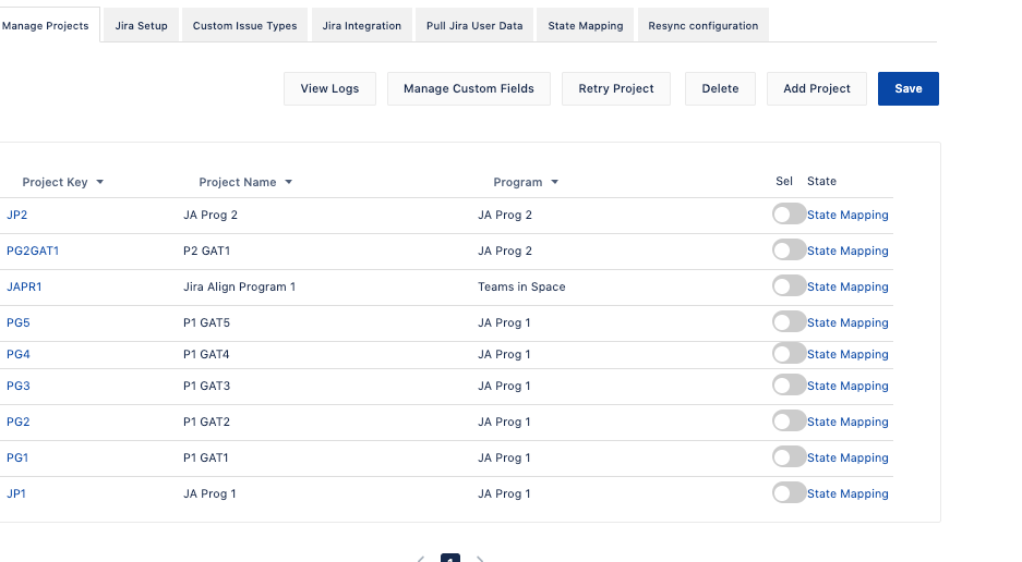

When you set up the connection between Align and Jira, you need to tell Align how to map the Jira issue state to one of the Align states. This is done in the Administration screens and needs to be done for each Jira project that you connect to Align. (Different Jira projects may have different workflows, so that's why it is done for each project.)
For the Stories, you need to go into the Jira Align Project Administration screen (Administration | Jira Settings | Manage Projects. There you'll see the projects you've got connected to Align. Screen Shot 2020-09-08 at 12.46.48 PM.png

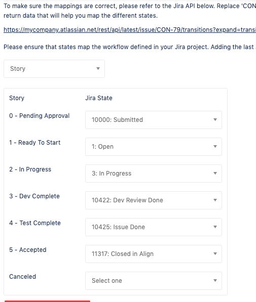

Then you click on "State Mapping" for the project you want. Pick the Story from the dropdown and you'll see the Align states. Pick the appropriate state from the dropdown list.
