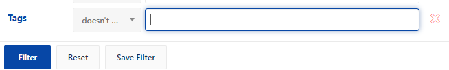

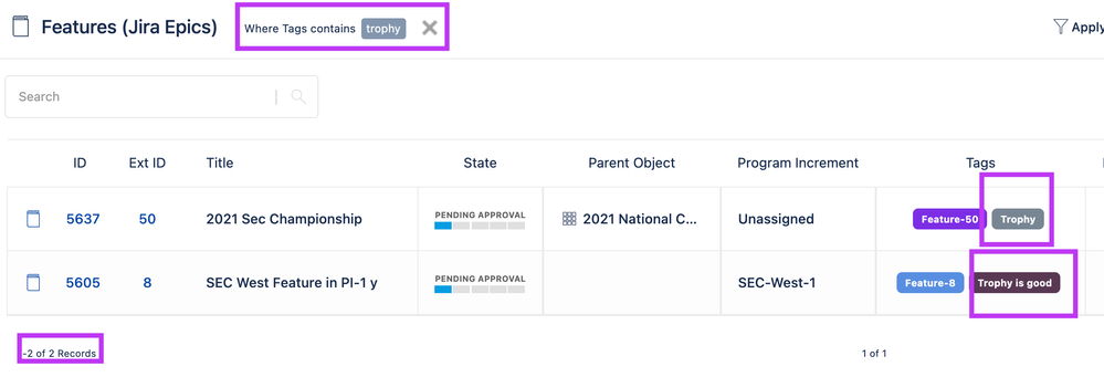

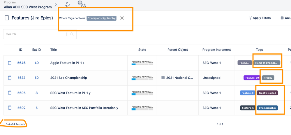

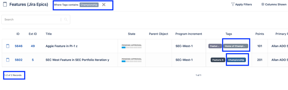

It works for me in the Grid View of Features.  Just use "Contains" and use commas to separate.  See pics.

@Razy Kased I stand corrected. Thanks @Allan Maxwell ! I didn't realize that worked with tags.

@Rae Gibbs you were correct in that it does not work from the little, quick-search box ...you have to go into "Filters".  So we are both correct.
