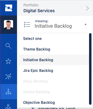

@Vinay Sharma If you select Portfolio > Backlog from the left navigation, the backlog dropdown in the upper left should display the respective backlogs. You may not have permissions to view the Epic backlog. Can you confirm you have permissions to view the backlog in the given Portfolio?
