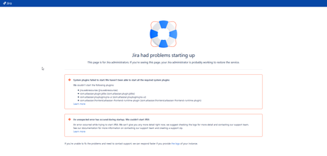

1.) Yeah, I run Jira as a service, but I needed to run it again so then I was connected to JIRA
And got the following Error:
It fails, when JIRA wants to start the Plugin System.
2020-07-10 17:29:29,104+0200 JIRA-Bootstrap ERROR [c.a.jira.startup.SystemPluginsEnabledHealthCheck] We couldn't start the following plugins:
- jira.webresources (jira.webresources)
- com.atlassian.plugin.jslibs (com.atlassian.plugin.jslibs)
- com.atlassian.jira.plugins.jira-ui (com.atlassian.jira.plugins.jira-ui)
- com.atlassian.frontend.atlassian-frontend-runtime-plugin (com.atlassian.frontend.atlassian-frontend-runtime-plugin)
Here is the log where the error occurs:
https://pastebin.com/CmbBJtR7
What I already did?
- Added "-Datlassian.plugins.enable.wait=300" as a parameter
- Deleted .jira-home.lock
- Checked Memory Size (All fine)

@amde1108 - this is helpful!
  • Can you confirm what version of Jira (e.g. 8.7?) you're trying to start?
  • Regarding the plug-in parameter, try increasing it (to 600) and see if that helps?

1.) I got JIRA 8.10. installed
2.) Tried it with 600 and then 900, still got the same error.
Here the full catalina log:
https://pastebin.com/vF7VnghV
I have no idea how to fix that.. :/
