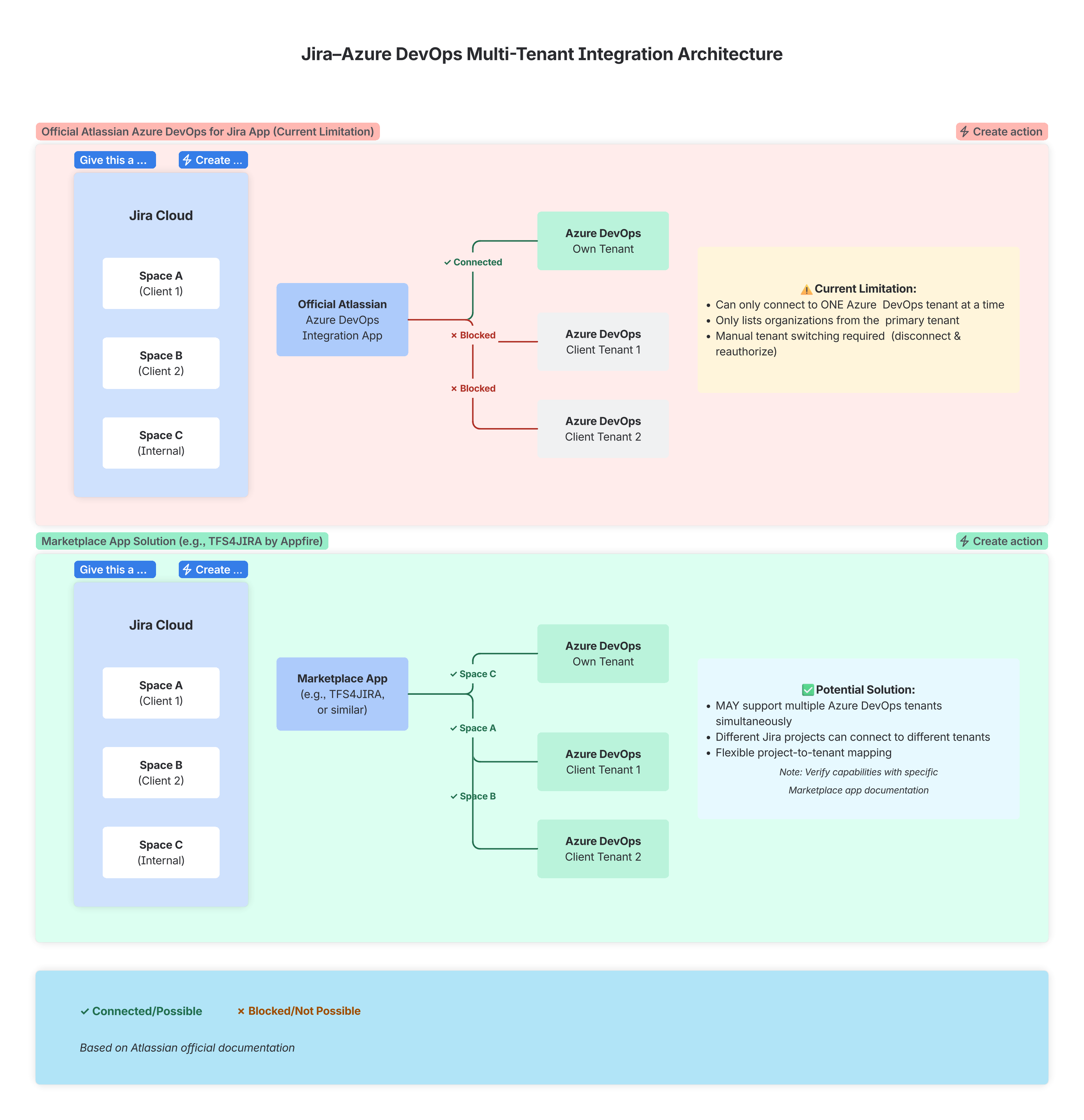

I’m exploring a setup where a single Jira instance is used to manage multiple clients, with separate Jira spaces (ex. projects) per client.
The requirement is:
  • Some Jira spaces should be connected to our own Azure DevOps tenant
  • Other Jira spaces should be connected to clients’ Azure DevOps tenants
  • The goal is to enable the Development panel integration (commits, PRs, etc.) per space + specific automations
So effectively, we would need space-level connections to different Azure DevOps tenants within the same Jira site.
From what I understand, the official Azure DevOps for Jira app does not support simultaneous connections to multiple tenants.
I’ve also seen that some Marketplace solutions might support this kind of setup, but I’m not a Microsoft/Azure DevOps expert and don’t have deep experience with DevOps integrations in general—so I may be missing something.
My question:
  • Is this type of multi-tenant integration possible in Jira today?
  • If not with the native Atlassian app, are there Marketplace apps that support this kind of setup (project-level tenant separation)?
I've drafted some visuals/flowcharts together with Rovo, so I'm curious if I'm understanding this correctly or not 👀
Any guidance, corrections, or real-world experiences would be greatly appreciated.

This is a supported use case for TFS4JIRA from Appfire. In both TFS4JIRA Self-Hosted and Cloud Native, you can set up multiple Azure DevOps connections (for different ADO instances/orgs) and then configure each sync profile to use the appropriate connection.

This is exactly the type of environment Exalate was built for. While standard integrations often link an entire Jira site to one Azure tenant, Exalate provides a much more granular approach. Since it works at the project level, it gives you a lot more control: Project A can talk to Client X, and Project B can talk to Client Y.
Because these connections are separate, you get the isolation you’re looking for. Each client connection is essentially 'sandboxed,' ensuring there’s absolutely no data overlap between different tenants. This allows you to manage project-level syncing for Client A and Client B independently, giving you full control over what stays private and what gets shared.
Regarding the Development Panel (the UI sidebar with commit counts), Exalate focuses on the deep synchronization of issue data and logic. While populating that specific UI panel across multiple external tenants might require a more specialized approach, if your main goal is driving automations and keeping client workflows in sync, Exalate handles that natively.

Yes, this is possible – but not with the official Atlassian app. The native Azure DevOps for Jira app does not support multiple tenant connections. You'll need a Marketplace alternative.
Solutions from the Community
  • TFS4JIRA (Appfire) – Supports multiple ADO connections with per-profile sync profiles
  • Exalate – Project-level sync with sandboxed tenant isolation
  • Unito – Two-way sync with filtering rules to separate clients
  • Zapier / n8n – Simpler one-way automation, good for basic needs
Key Considerations
  • Permissions – You'll need appropriate access to each client's ADO tenant
  • One-way vs. two-way – Decide if Jira → ADO sync is required (some tools handle only one direction)
  • Development Panel – Verify with vendors whether the PR/commit sidebar works across multiple external tenants
