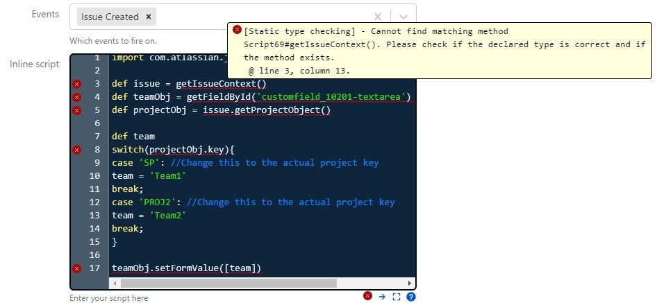

Ronak
December 31, 2019
Hello Bryan,
I am getting error when I have used above code in script listener.  Attached screenshot.
Thanks,
Ronak
brbojorque
December 31, 2019
Hi @Ronak ,
It will be a slightly different script, unfortunately I'm mobile right so I cant get you the right one.
I will add the script as soon as I can.
