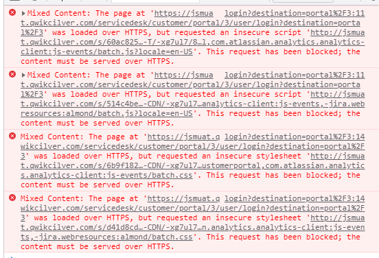

@Nic Brough -Adaptavist- to give you more details on the issue Akshay posted, we had enabled SSL from load balancer and were able to access the portal using our https://jira.[servername].com.
But when we try loading to customer channel URL we seeing this issue in developer console.
I still understand, we need to make some changes to the server.xml for internal redirecting. it would be better if you could help us with that.

So not what Akshay said at all.
This error happens when you have got the service incorrectly configured, it's not serving everything as secure content.
Look first at the connector settings in the server xml, I suspect you've not set the secure/https/secure port correctly.

I have attached server.xml
i haven't changed anything default 8080 connector is only enabled
