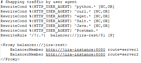

After a long time researching and trying, I was able to re-route the REST traffic as per our standards.
This is what we did:
  • For 2-3 months, monitored the access logs for all different agents that accessed Jira and took note of them.
  • We put the following on our apache config file:
This is not the best solution but it does the job.
Hope this can help other people too.
