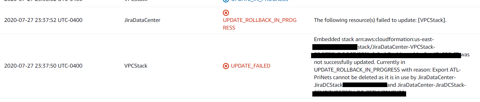

Now, I can't update the root stack - I get a host of errors related to export variables. This is just one of the errors, they change depending on which parameters I'm modifying, but they are always of the form "Export ______ cannot be deleted as it is in use by JiraDataCenter."
For context, I was modifying the instance size (c5 -> c5.xl) and number of nodes (both decreasing to 0 and increasing to 2 or 3). I have tried modifying pretty much every parameter and it will not succeed. I've also tried changing the prefix from "ATL" to "JDC" or something.
