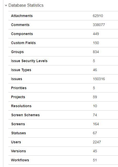

Current instance stats:
"Archived" Projects, which generally I have mapped to a permission scheme, accessible only for audit and reporting users, are a good thing, but still all issues are loaded in lucene indexes.
Partial indexing of issues would be a good improvement, but I don't think it would be the only one needed as I'm sure the performance stretches further than just indexes.

With instances getting as big as yours I can imagine that something "real" is needed.

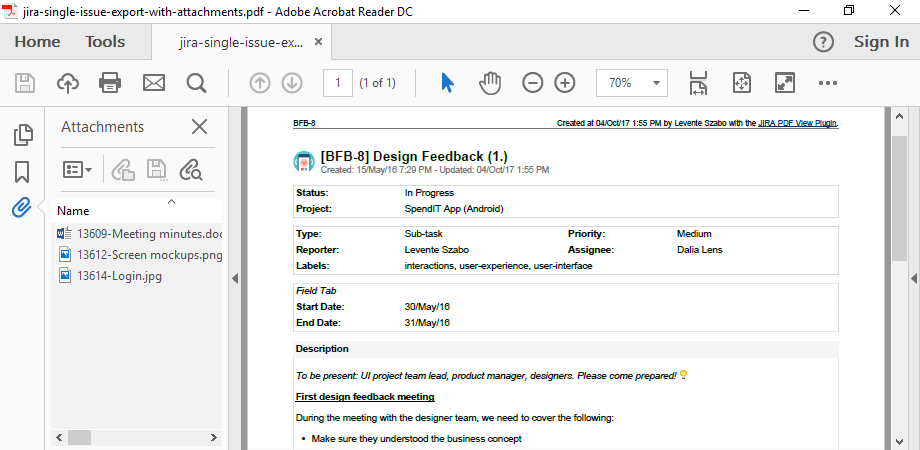

Have you considered exporting your issues from Jira, then permanently deleting them from Jira? This would ultimately decrease the load on Jira.
For example, using the PDF View Plugin you could export them to PDF files, in which you have full control what fields to include, whether to include comments, attachments (even their binary content!), change history, links, etc.
Here is a couple of samples.
jira-single-issue-export-with-attachments
Then you could put these documents to any document management system which can index them for future searches.
The drawback of this approach is that it does not enable easily restoring issues from the archives, although I am not sure if that is a requirement here. (You could still restore issues manually from the PDF if there is an infrequent need for that. Or even write a script that parses the content from the PDF and creates the issue via the Jira REST API.)
