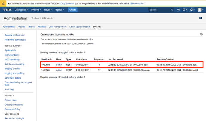

I believe there is a way you can see if these REST API calls are being diverted as expected.  Try these steps:
  1. Login directly to the specific node that you want to divert this traffic to. (in order to do this, you might need to make sure this node has a separate connector that bypasses your load balancer.  One way is to follow the steps in How to bypass a Proxy and SSL to test network connectivity.  And then connect to this node over that local address/port number, such as hostname:9999 instead of the address of your load balancer such as jiradatacenter.example.com .)
  2. Sign in as a Jira admin, and navigate to Gear Icon -> System -> Security -> User Sessions. (This page shows you all the user sessions connected to this node)  You can also reach this by going to [hostname:portnumber]/secure/admin/CurrentUsersList.jspa
  3. Try then to open a command prompt / terminal session
  4. Use a utility like curl to make a REST call directly, example command such as:
    curl -D- -u username:password -X GET -H "Content-Type: application/json" http://jiradatacenter.example.com/rest/api/2/issue/createmeta
  5. Check the page on step 2.
If this is working that node will indicate that there is a specific rest call being made to this node.   Since this call did not request the login.jsp page, we know this call is not be originated by a web login to Jira.  In this case, when you make a curl call, it is purely a REST request to Jira datacenter.   We should see that specific node identifying this as a type=rest with the username you defined in the curl call, and the ip address this originated from.  Example screenshot below.
If you don't see this specific call, you might want to login to the other nodes in a similar manner to see if you can track down this specific call to see which node it was directed to.
