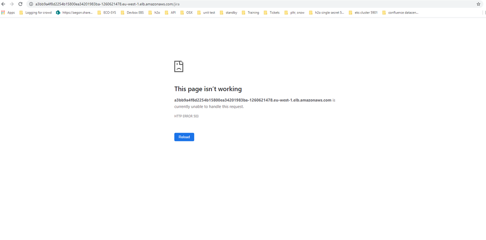

I got these results with the dns of the lb:
with path /jira - HTTP ERROR 503
The pod is running, the service looks fine, here are the logs from the controller pod:

192.168.14.217 - - [04/Aug/2021:21:19:32 +0000] "GET /jira HTTP/1.1" 503 40 "-" "Mozilla/5.0 (Windows NT 10.0; Win64; x64) AppleWebKit/537.36 (KHTML, like Gecko) Chrome/91.0.4472.164 Safari/537.36" 494 0.044 [datacenter-jira-datacenter-80] [] 192.168.61.127:8080 40 0.044 503 3ec78d4929bb54b408d3769aceccefda
I0804 21:19:39.282324 7 status.go:284] "updating Ingress status" namespace="datacenter" ingress="jira-datacenter" currentValue=[] newValue=[{IP: Hostname:a3bb9a4f8d2254b15800ea34201983ba-1260621478.eu-west-1.elb.amazonaws.com Ports:[]}]
I0804 21:19:39.296313 7 event.go:282] Event(v1.ObjectReference{Kind:"Ingress", Namespace:"datacenter", Name:"jira-datacenter", UID:"8b74da63-ee0a-4530-9665-62e20d3bd28e", APIVersion:"networking.k8s.io/v1beta1", ResourceVersion:"20166", FieldPath:""}): type: 'Normal' reason: 'Sync' Scheduled for sync

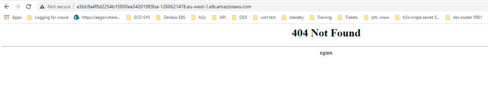

192.168.60.51 - - [04/Aug/2021:21:20:48 +0000] "GET / HTTP/1.1" 404 146 "-" "curl/7.61.1" 135 0.001 [upstream-default-backend] [] 127.0.0.1:8181 146 0.000 404 7fc6bcd42b1af0ad88827857c46eb81f
192.168.14.217 - - [04/Aug/2021:21:20:54 +0000] "GET /jira HTTP/1.1" 503 5 "-" "curl/7.61.1" 139 0.005 [datacenter-jira-datacenter-80] [] 192.168.61.127:8080 5 0.004 503 cd37d9a242688e04de399ad4625670ea

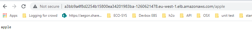

I spinned up a simple app (https://aws.amazon.com/blogs/opensource/network-load-balancer-nginx-ingress-controller-eks/) just to test the clb with another ingress, it works fine:
I also tried internal clb and alb with different configs in our organizational account but the one that I detailed above is the one that you recommended but it is still not working :(

-bash-4.2$ export POD_NAME=$(kubectl get pods --namespace datacenter -l "app.kubernetes.io/instance=jira-datacenter" -o jsonpath="{.items[0].metadata.name}")
-bash-4.2$ echo POD_NAME: $POD_NAME && echo POD_STATUS: $(kubectl get pod $POD_NAME -o jsonpath='{.status.phase}')
POD_NAME: jira-datacenter-0
Error from server (NotFound): pods "jira-datacenter-0" not found
POD_STATUS:
-bash-4.2$ kubectl --namespace datacenter port-forward $POD_NAME 8080
Forwarding from 127.0.0.1:8080 -> 8080
Forwarding from [::1]:8080 -> 8080
^C-bash-4.2$ k logs -n datacenter jira-datacenter-0 | grep ERROR
-bash-4.2$ k logs -n datacenter jira-datacenter-0 | grep Error
-bash-4.2$ k logs -n datacenter jira-datacenter-0 | grep error
-bash-4.2$ k get -n datacenter events
LAST SEEN TYPE REASON OBJECT MESSAGE
7m51s Normal Scheduled pod/jira-datacenter-0 Successfully assigned datacenter/jira-datacenter-0 to ip-10-129-103-123.eu-west-1.compute.internal
7m51s Normal Pulling pod/jira-datacenter-0 Pulling image "atlassian/jira-software:8.13.9-jdk11"
7m33s Normal Pulled pod/jira-datacenter-0 Successfully pulled image "atlassian/jira-software:8.13.9-jdk11" in 17.930797725s
7m23s Normal Created pod/jira-datacenter-0 Created container jira
7m23s Normal Started pod/jira-datacenter-0 Started container jira
7m34s Normal Scheduled pod/jira-datacenter-application-status-test Successfully assigned datacenter/jira-datacenter-application-status-test to ip-10-129-103-12.eu-west-1.compute.inte rnal
7m34s Normal Pulling pod/jira-datacenter-application-status-test Pulling image "alpine"
7m33s Normal Pulled pod/jira-datacenter-application-status-test Successfully pulled image "alpine" in 1.746776338s
7m33s Normal Created pod/jira-datacenter-application-status-test Created container test
7m32s Normal Started pod/jira-datacenter-application-status-test Started container test
6m59s Normal Scheduled pod/jira-datacenter-application-status-test Successfully assigned datacenter/jira-datacenter-application-status-test to ip-10-129-103-12.eu-west-1.compute.inte rnal
6m59s Normal Pulled pod/jira-datacenter-application-status-test Container image "alpine" already present on machine
6m59s Normal Created pod/jira-datacenter-application-status-test Created container test
6m59s Normal Started pod/jira-datacenter-application-status-test Started container test
6m56s Normal Scheduled pod/jira-datacenter-shared-home-permissions-test Successfully assigned datacenter/jira-datacenter-shared-home-permissions-test to ip-10-129-103-12.eu-west-1.compute .internal
6m56s Normal Pulling pod/jira-datacenter-shared-home-permissions-test Pulling image "debian:stable-slim"
6m52s Normal Pulled pod/jira-datacenter-shared-home-permissions-test Successfully pulled image "debian:stable-slim" in 3.223335995s
6m52s Normal Created pod/jira-datacenter-shared-home-permissions-test Created container test
6m52s Normal Started pod/jira-datacenter-shared-home-permissions-test Started container test
6m51s Normal Killing pod/jira-datacenter-shared-home-permissions-test Stopping container test
7m52s Normal SuccessfulCreate statefulset/jira-datacenter create Pod jira-datacenter-0 in StatefulSet jira-datacenter successful
-bash-4.2$ k get -n datacenter ep
NAME ENDPOINTS AGE
jira-datacenter 100.64.67.179:8080 8m16s

If I try this same method with the simple 'apple' app then I got the same error after the second command and in the browser. But if I curl localhost:5678 then I get the reply 'apple'.
If I curl localhost:8080, I get an empty reply but it shows that handling connection:
Handling connection for 8080
Dylan Rathbone
August 5, 2021
Hi Balazs,
On the 27th July you had mentioned that you could in fact load the confluence setup page via the browser by using the external IP of the load balancer. Is this no longer the case?
Can you also please supply the output for:
  • kubectl get pods --namespace datacenter
  • kubectl describe pods --namespace datacenter
  • the values.yaml file you are using for deploying confluence.
Thanks.
