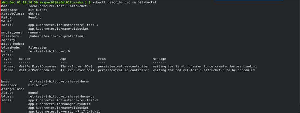

Ah, I missed that the pod is in pending state. Odds are the PVC has never been bound and the pod has unbound PVCs. Let's take a look at events in  kubectl describe. I'd also look at kubectl describe pvc too.

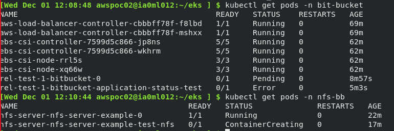

Here is the output from kubectl describe.
From the kubectl pods output attached above, I believe all the prerequisites are in place.

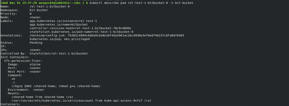

@Himanshu Sinha can you please provide output from kubectl describe pod rel-test-bitbucket-0 -n bit-bucket? Events in there will shed some light

Here is the output
Yevhen
December 1, 2021
@Himanshu Sinha sorry, wrong pod name, it's rel-test-1-bitbucket-0 - the one that is in a Pending state.

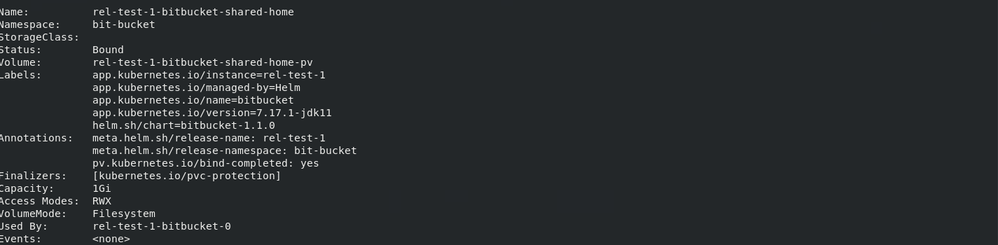

Hey @Himanshu Sinha
from the describe output you supplied for the PVC I cannot see anything obvious that would prevent the pod from starting.

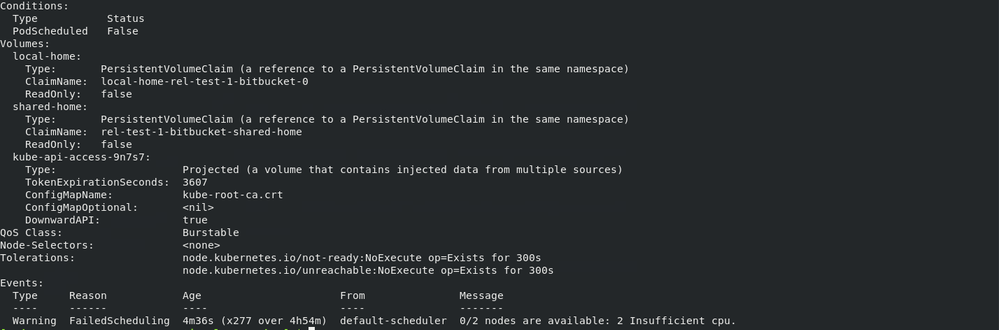

@Dylan Rathbone  Before I tried the next step here is the output as suggested by @Yevhen
I was using t3.medium. Then I tried with m5.large and still the same issue - Insufficient CPU.
I did kubectl describe node and there doesn't seem to be CPU issue.

Dylan Rathbone
December 1, 2021
So an m5.large only has 2 cpu's and the default cpu request size in the values.yaml is 2...
container:
requests:
cpu: "2"
My understanding is that K8s needs to allocate some compute for itself so you cannot allocate the full 2 cpu's to your pod. Try dropping the request size down to 1.75 or 1 and see what happens

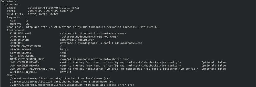

Here is pod resource request
jvm:
 maxHeap: "1g"
 minHeap: "512m"
container:
 requests:
  cpu: "1" -- Tried with "1.75" as well. It didn't help
  memory: "2G"
Yevhen
December 1, 2021
@Himanshu Sinha  experiment with cpu request. So far, it's purely K8s issue - the cluster does not have a worker node with enough cpu. And yes, if the node has 2 vcpu it does not mean all of them are allocatable. Try with a small request like 500m for example.
Like Dylan Rathbone likes this
