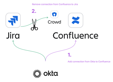

I came up with an idea to visualize this (not sure why 😅)
Current setup:
Updated one (steps)
As Fabio said, it should be possible.
If you have dev/staging environments, the recommendation would be to test it there first, but in short, you could try to go with the following approach:
  1. Add Okta to Confluence (set this directory as the highest priority)
  2. Sync users and groups from Okta (make sure all users and groups needed for permissions and access exist in Okta before disconnecting the old directory)
  3. Remove the Jira directory from Confluence
One of the risks would be that permissions tied to old directories may need to be re-mapped, but that's pretty obvious, I would say.
