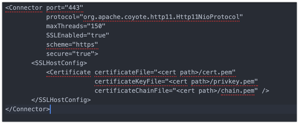

If talking about the SSL certificate, then Crowd doesn't directly integrate with it. Only Apache Tomcat holds all required configurations for support SSL.

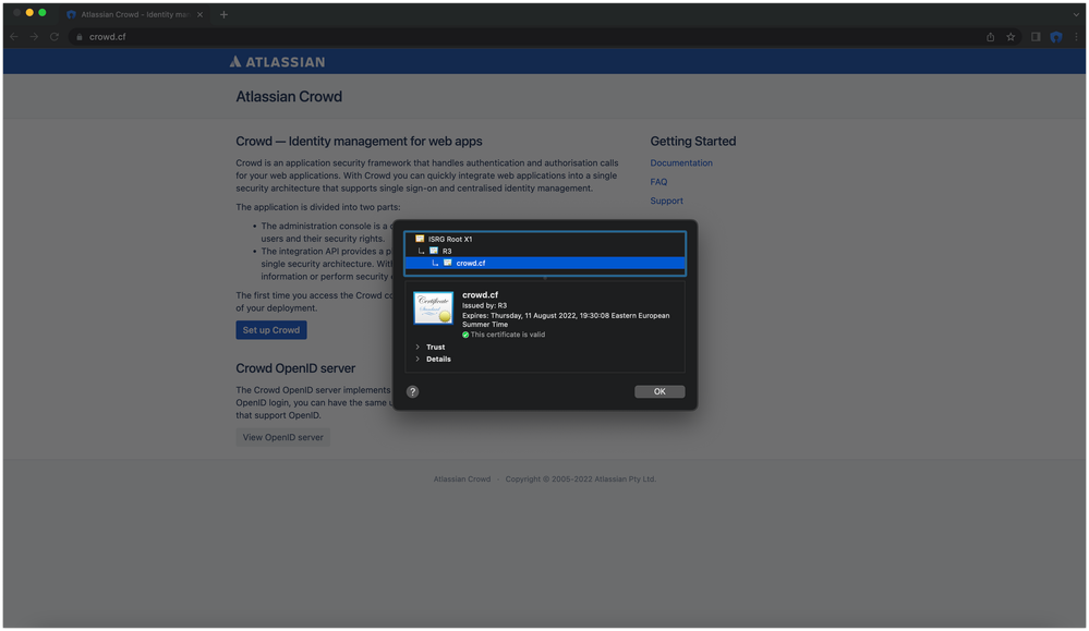

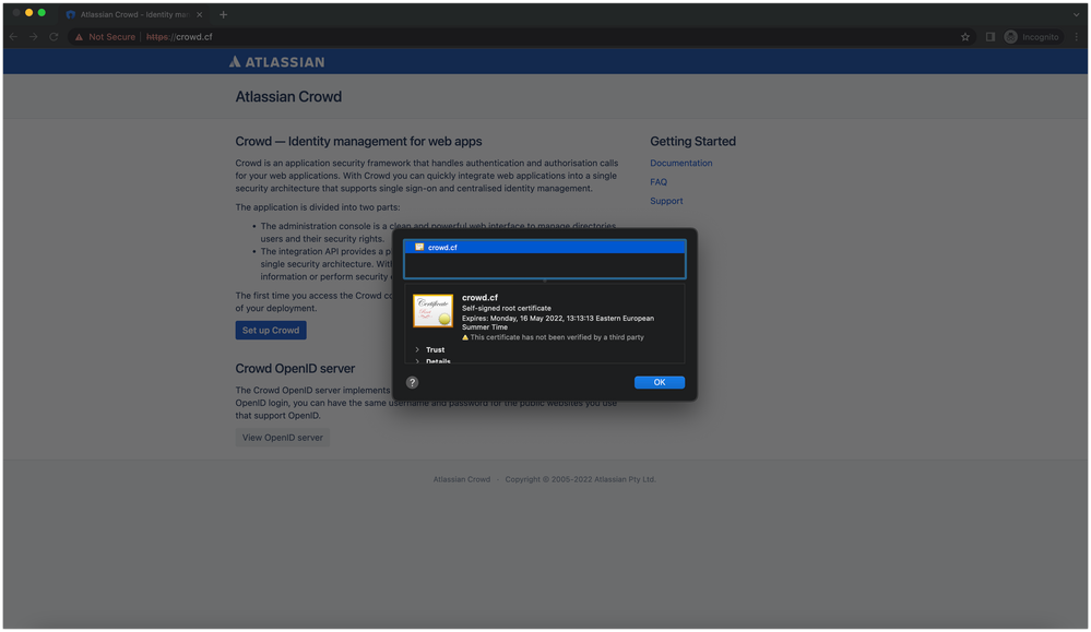

I checked the proposed configuration (official Atlassian Crowd documentation) with the Self-Signed certificate and with a certificate issued by CA (https://letsencrypt.org). In both cases, everything works as it should, but the Connector configuration for a certificate issued by Let's Encrypt is a little bit changed (see below).
