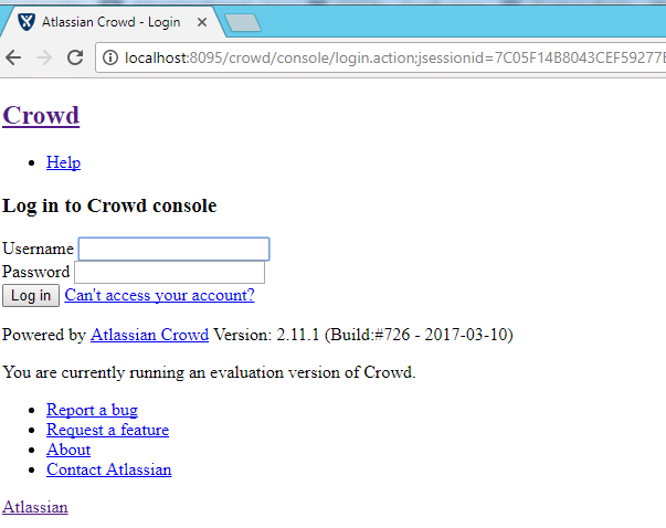

We are not getting proper window for crowd after the migration.please help us
Marcin Kempa
November 17, 2017
Hi @vivuu
It looks like you are running into similar problem as described here.
The root cause of this problem may be CWD-4968 or CWD-4999 depending on what changed operating system or Java.
Please use the workaround as described in CWD-4968
Best Regards,
Marcin Kempa
vivuu
November 17, 2017
It Worked,
Thanks a lot for fixing the issue..
