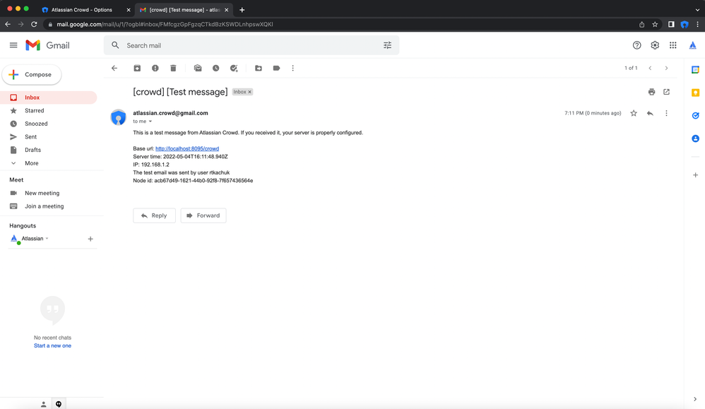

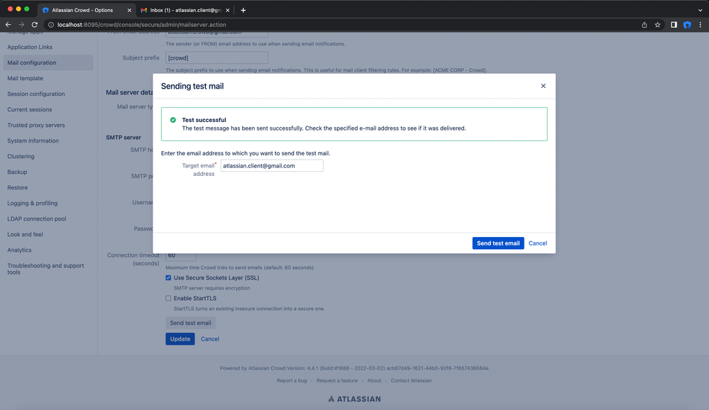

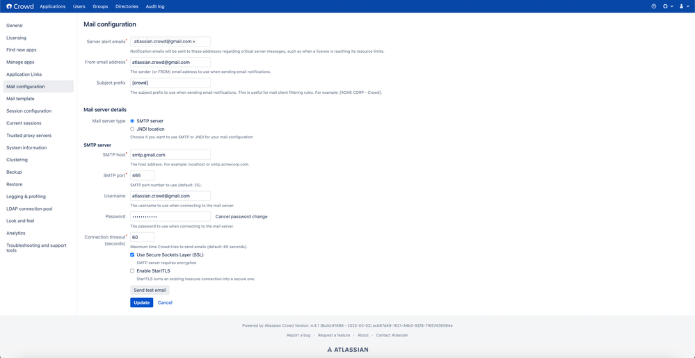

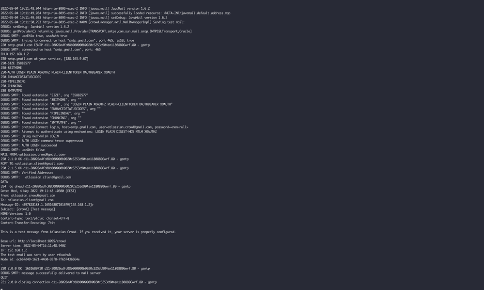

Hi @Alexander
I checked the integration Crowd v4.4.1 DC (locally installed) with Google Mail Server as described here https://confluence.atlassian.com/crowdkb/how-do-i-configure-crowd-to-use-gmail-as-the-mail-server-938024980.html
so all works pretty fine. See screenshots and Crowd mail log file below

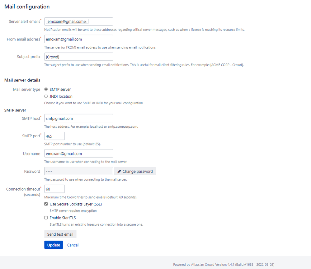

Alexander
May 4, 2022
Turned off two-factor authentification and thats the log
DEBUG: setDebug: JavaMail version 1.6.2
DEBUG: getProvider() returning javax.mail.Provider[TRANSPORT,smtps,com.sun.mail.smtp.SMTPSSLTransport,Oracle]
DEBUG SMTP: useEhlo true, useAuth true
DEBUG SMTP: trying to connect to host "smtp.gmail.com", port 465, isSSL true

DEBUG SMTP: protocolConnect login, host=smtp.gmail.com, user=emoxam@gmail.com, password=
DEBUG SMTP: Attempt to authenticate using mechanisms: LOGIN PLAIN DIGEST-MD5 NTLM XOAUTH2
DEBUG SMTP: Using mechanism LOGIN
DEBUG SMTP: AUTH LOGIN command trace suppressed
DEBUG SMTP: AUTH LOGIN failed

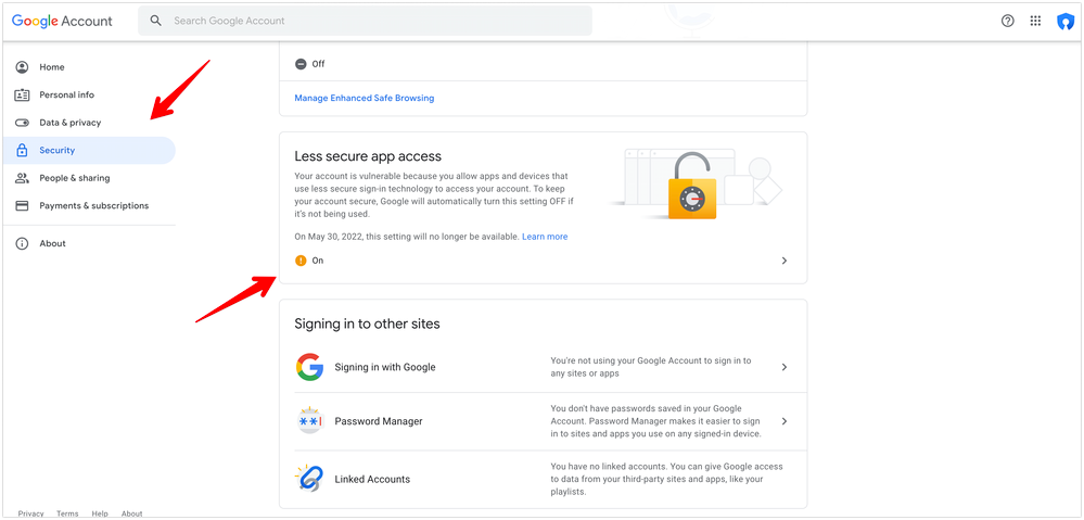

Hi @Alexander
You need to allow "Less secure app access" in your emoxam@gmail.com account
