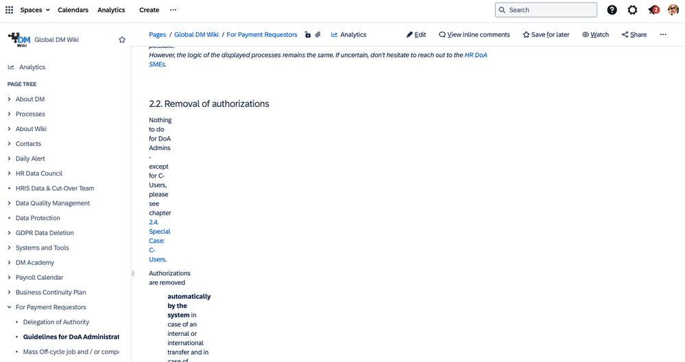

I noticed some pages with strange (narrow) layout in view mode:

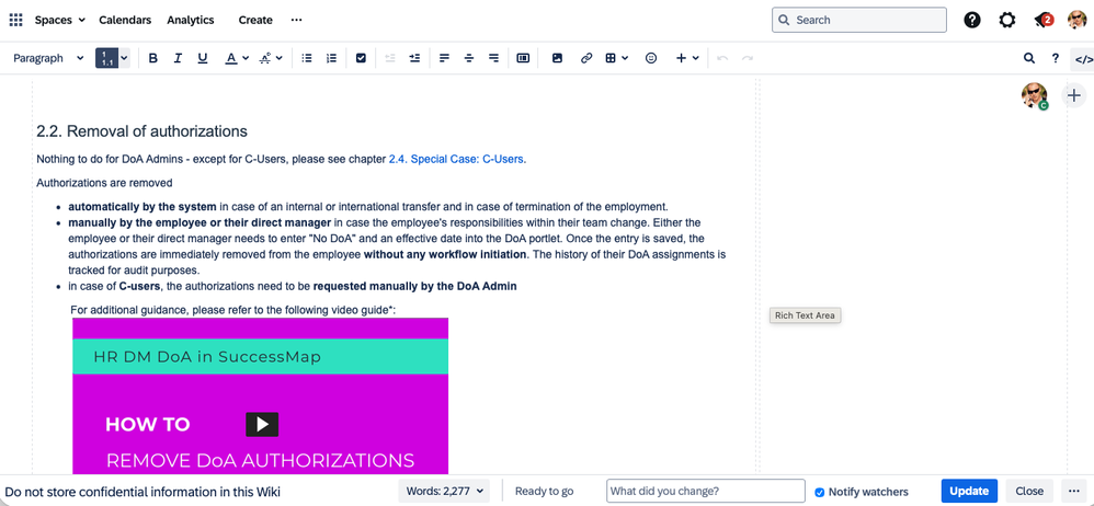

In Edit mode it seems fine:

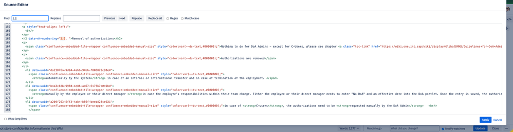

The source code also looks fine:

@david cockrell did you copy and past this content from another website?  If the answer is yes there is most likely CSS or HTML impacting it.  The screenshot you shared of the pages HTML is only of the paragraph section.  You would need to look further up to see if there is a div or something else impacting layout.

I did some testing:
first, I've copied the page to my personal space. layout of the page is still incorrect.
Then I've copied the entire source code of this page into an online HTML viewer (https://html.onlineviewer.net/)
There the layout of the page is correct.
hmmm... maybe some kind of Confluence bug?
