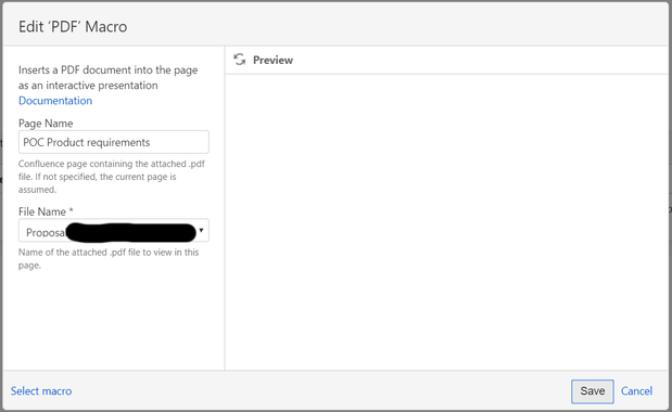

I'm not sure if I'm experiencing the same bug or a related one. I'm trying to preview a PDF on another page. When I'm editing the macro, I can see the PDF in the list of files fine, but nothing happens when I try to preview it in the preview section of the Edit macro dialogue box, and when I click on Save nothing happens. Is this the same bug or a different one?
Edit: I'm (currently) using Chrome version 78.0.3904.108.

Hi Shannon, a few things
  • I'm using Chrome, not Firefox or Safari
  • I'm not trying to edit a file using the Atlassian Companion app. There's a PDF file attached to page A, and I'm trying to insert it on page B using the viewpdf macro. Both pages are in the same space.
  • When I try to do this using the macro, I'm able to find the PDF fine, but it won't display in the Preview pane, and clicking on the Save button does nothing (even though it's clickable). The edit PDF macro looks like this when I try to use it: viewpdf macro screenshot.png
I'll raise a ticket with support in any case.

In talking with support, it looks like this is a bug with the viewpdf macro, it's in Atlassian's list of bugs to fix: CONFCLOUD-67859: Can't insert pdf attachment in pdf macro .

Greetings all - I've had this issue as well. I'd like to ask if the pages you have issues with this on have a colon in the page title. I've noticed that pages that have a ":" in the page title, the PDF macro will not show the list of attachments. Once you remove the colon, it works fine.

Alexandra Dodds
January 2, 2020
My Page title had a ':' in it and you're right - just changed the page title and it worked
