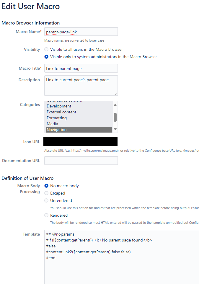

Hello,
this user macro, that I posted a picture of below, suddenly stopped working and is only displaying  $htmlUtil.htmlEncode($content.displayTitle)
I can't seem to fix it. I think this happend after the last patch of Confluence to version 8.5.4.
How can I fix it? We use this macro a lot in our organization.

Hello @Sara von Hofsten ,
I can see that HtmlUtil should be available in velocity context according to the docs: https://developer.atlassian.com/server/confluence/confluence-objects-accessible-from-velocity, but really, it is not.
As an option, if HTML is rendered with a variable assignment, the variable name needs to end with "Html". This will render HTML instead of escaping it.
Example: $outputHtml instead of $output
So you can try to create the variable with the title ending with 'html' to be escaped, like:
#set($titleHtml = $content.displayTitle )
$content.displayTitle ## as is
<br>
$titleHtml ## escaped
<br>
https://confluence.atlassian.com/doc/user-macro-template-syntax-223906130.html
Sara von Hofsten
February 27, 2024
adding HtmlUtil to string in setenv.sh fixed the html problem.
The macro output looks correct but there's some problem with the lik to parent page. I get page not found or insufficient permission error, but i guess it's a macro problem and not a server problem :)
