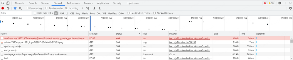

I didn't use nginx/apache proxy and use tomcat directly.
When I edit a new document, it shows that POST 404 "http://10.1.80.29:8090/synchrony-proxy/v1/data/Synchrony-23cb09de-8381-30a1-94e7-021e15acf320/confluence-45580290?state-at=@head&state-format=type-tagged&rewrite-request=true&cached=true"

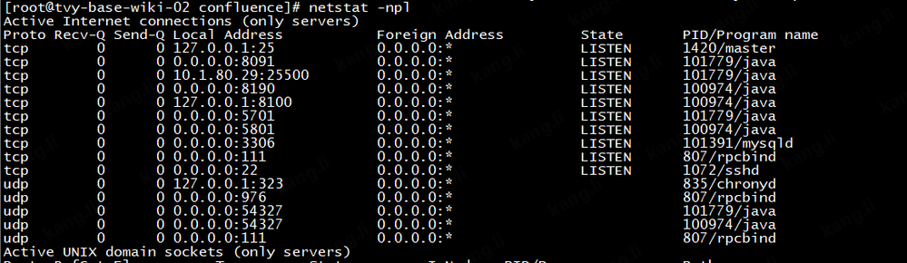

My synchrony works on 8091 port.It can be seen in "netstat -npl".I set up a new confluence as a test.All the configure is default.
But when I edit a document,I still get "POST 404 error"
