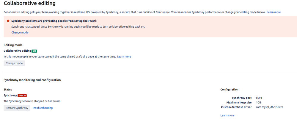

I have changed in /home-directory/bin/setenv.sh to increase heap dump for synchrony:
CATALINA_OPTS="-Dsynchrony.enable.xhr.fallback=true ${CATALINA_OPTS}"
CATALINA_OPTS="-Dsynchrony.memory.max=2g ${CATALINA_OPTS}"
