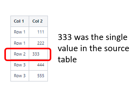

any additional recommendations on how to get the output to format correctly if a cell only had one value?
For example:
Source Table
Col 1Col 2
Row 1111, 222
Row 2333
Row 3444, 555
Output Table
Stiltsoft support
Atlassian Partner
October 9, 2024
This row wasn't modified, so as the source table had the left align, such orientation was preserved for the untouched cells.
You may use the right align for the source table or add another Table Transformer macro on top of the first one with the FORMATWIKI function: https://docs.stiltsoft.com/tfac/cloud/changing-alignment-188620085.html
