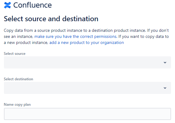

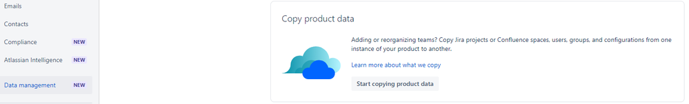

MUST HAVE ORG-ADMIN PERMISSIONS FOR THE SOLUTION BELLOW.
One option that can work ( I have not tried this myself since my issue is specifically my sandbox ) is doing the import into the confluence cloud sandbox instance.
Select the projects that you have imported to copy over and start. They will notify you once the process is complete.
My specific problem seem to have steemed from corrupted data within my confluence for the specfic projects I had to import. Since they existed before and then they were deleted in order to test the migration again, this had some weird effect on the import. When I did this within a different confluence instance the import worked just fine.
