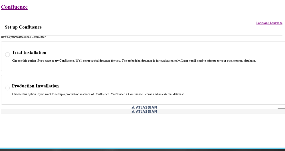

I can see the radials to setup confluence but when I click on it nothing happens?

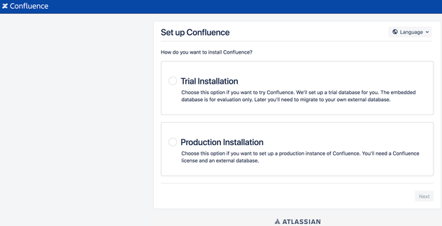

It should have styling applied so there is an issue of some kind. See how it is supposed to look:

At which screen does it stop responding? Please post a screen shot if possible.
The very first screen where I pick trial or production installation. I was having issue connecting it to our database so I now want to do a trial installation so I can get this get everything setup and import my database later.

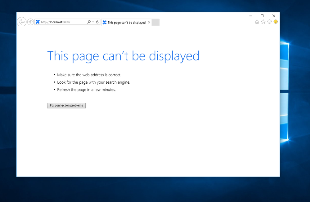

I did what you suggested and that didnt work so i did a uninstall and made sure all confluence folders and files were gone. I did a reinstall picked express it went through a process but I did not get the above screen at all this time and the application just closed.
