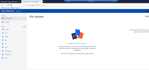

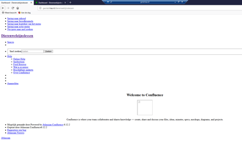

when rewriting with IIS to confluence 6.12.2 version we get a strange bug (see image below).
he has to look like this:

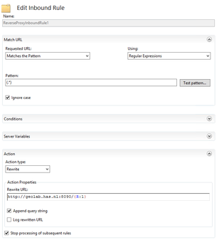

The rewrite in IIS is done as shown below, does anybody know a solution to repair the rewrite.

Hello there! Could you clarify some points for us:
  1. Has this worked at some point in the past?
  2. Is this your productions instance?
  3. What was the answer provided in the past for you, regarding this issue?
  4. Does Confluence work without the proxy?
  5. What version is your IIS currently?
  6. Were you able to check the documentation on URL Rewrite for IIS?
  7. Could you share more information on the current settings for IIS?
  8. Could you share more information on how was IIS setup?
  9. Is this proxy also serving another application?
Also, could you clarify if your proxy meets the requirements here:
Proxying Atlassian server applications with Microsoft Internet Information Services (IIS)
You can find the documentation for URL rewrite on the link above.
Let us know!
geolab has
February 20, 2019
the answer was solved with your suggestion, thanks!
